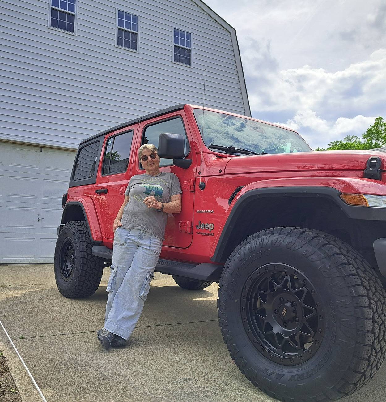

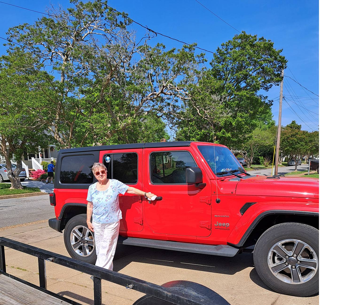

Before and after. I think she is done for this year. I have other things that require my play money for a while
So far
Yeti Track bar
Teraflex Ball Joints
Metalclaok Steering system
Mopar 2 inch lift
35x12.5 Toyo OC AT III on 18x9 RC Rims
HD Spare Tire bracket
Next Year will look at Bumper systems and winches
Jeep Wrangler JL 21 Sahara U pre-build Stock with 32 inch tires

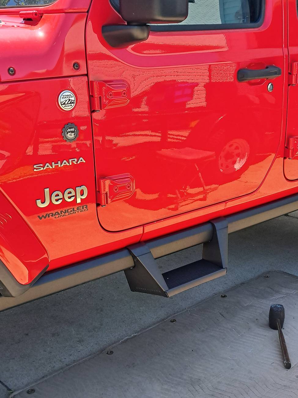

As these projects usually go, you think you are done for a while and no you are not. Wife is too short and "Her Beastie" is too tall. She manages but it is a struggle to climb in. I picked up a set of lightly used OEM rock rails this morning. Now to wait on Nxtgen to release their removable steps then I can swap out her stock running boards for a better system. We also went to a graphics shop to contract some vinyl for the hood shoulders. Should see some design choices in a day or two.
So now a week later and I have to say the mopar lift and replacing all the major front end control parts has this thing riding pretty darn nice on the 35" tires. About 75 she starts feeling a bit boundy but up to that she feels better than some of her other Wranglers when they were brand new stock. We are both very pleased. Steering is light and a hair more sensitive (especially to road crown) than it was with the stock rubber but generally it feels planted and stable.

Wife's graphics and yesterday I swapped the floorboards for the rock rails and installed the nxtgen steps.
