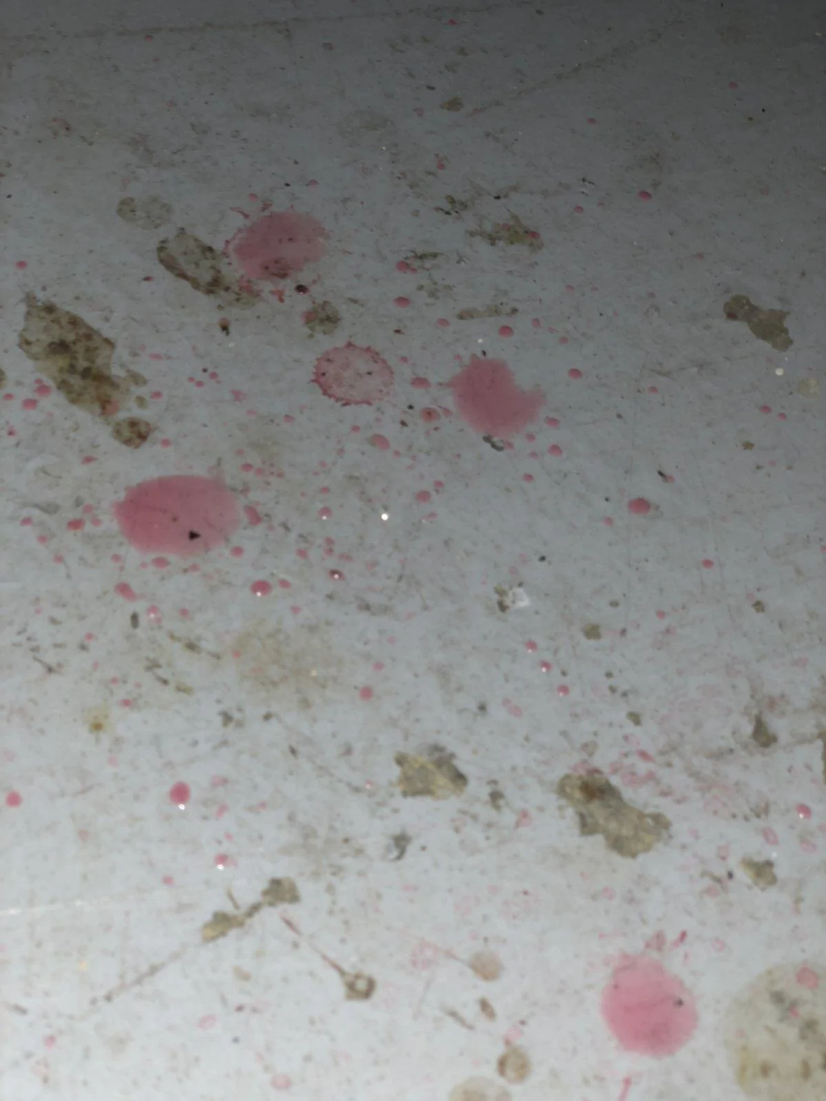

Found this under the Jeep after driving home from work. Appears to be coolant. 3800 miles. Anyone have this happen?

What’s the viscosity of it? Watery or oily? It looks almost like the ATF I used to put in my YJ’s transfer case but unless it was below the middle of your jeep I wouldn’t think it’s that. It looks too pink to be power steering fluid. Probably coolant like you said

Hopefully it's the coolant pump that can be replaced relatively easily. Common issue.

They said it was a radiator leak. I’ll have it back tomorrow. I wonder if they will replace the radiator or will they just patch the leak?

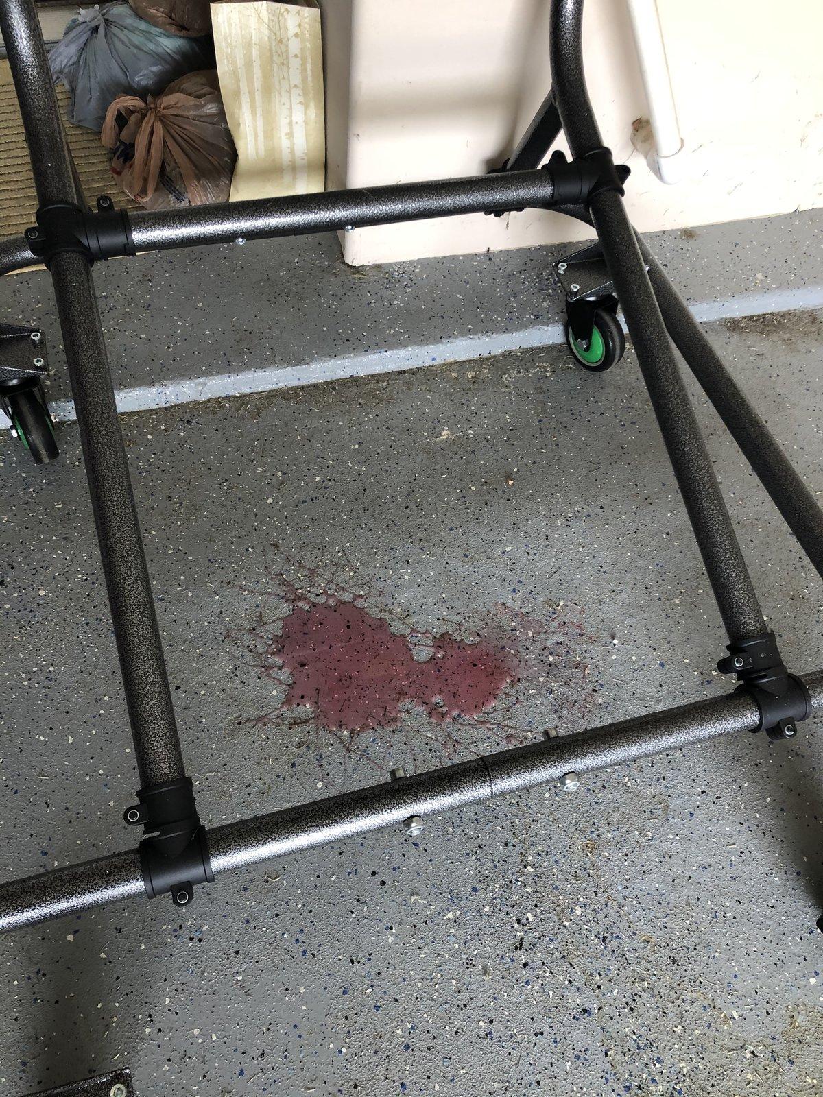

Same issue today on my 2018 JLU Sahara. Front, driver side, kind of oily viscosity.

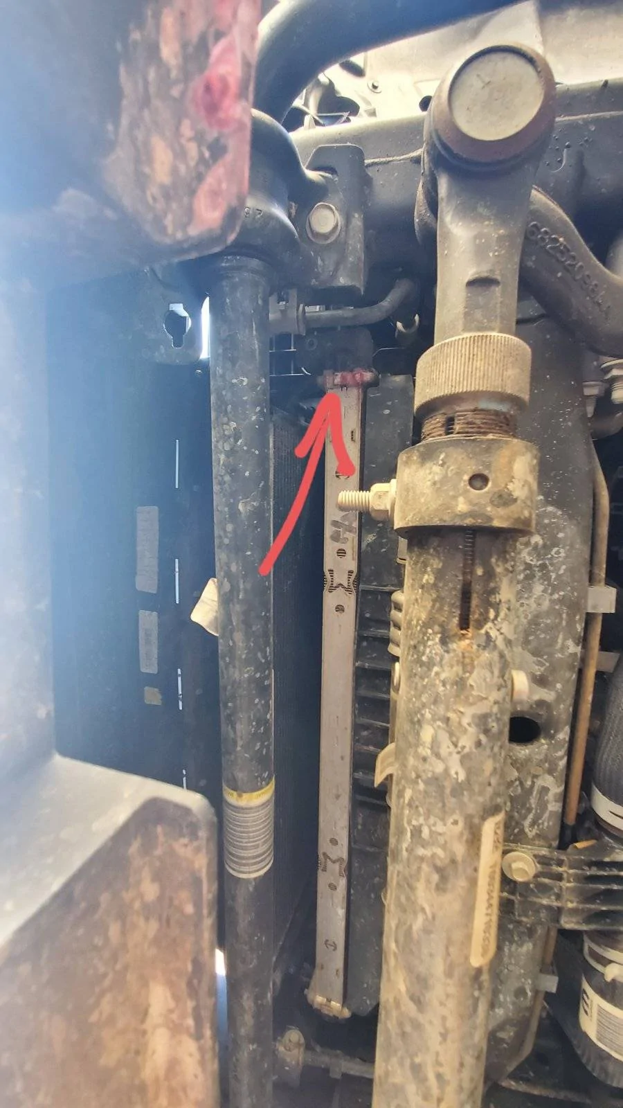

I had the radiator replaced on my 2019 with about 500 miles on it.

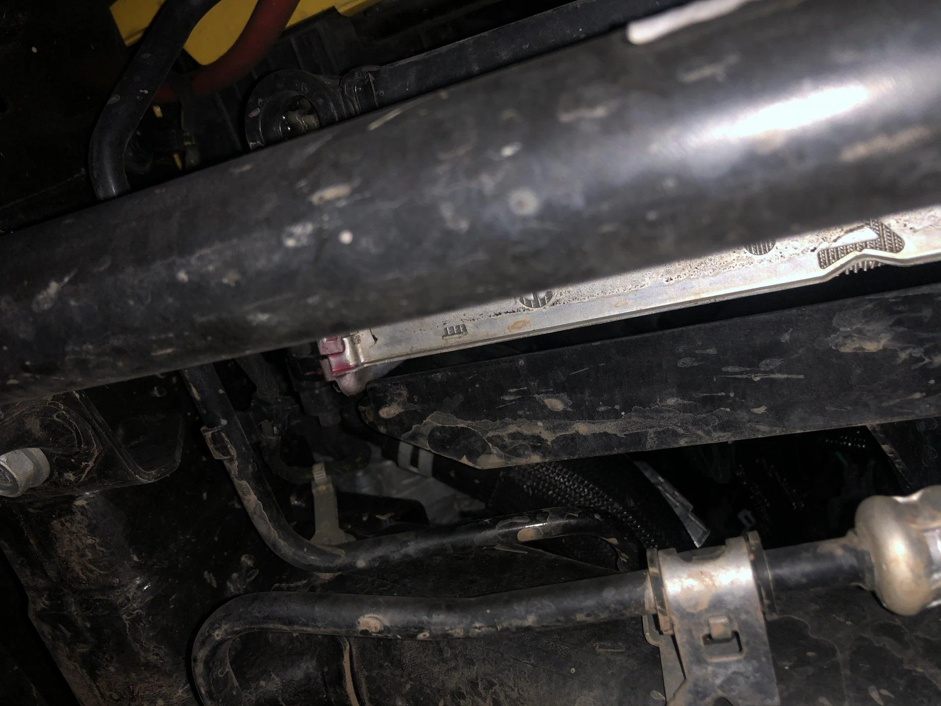

Same.. I know they have a "service bulletin" for certain radiator models but mine is not on the list and I think my jeep is out of warranty (60k miles already)
