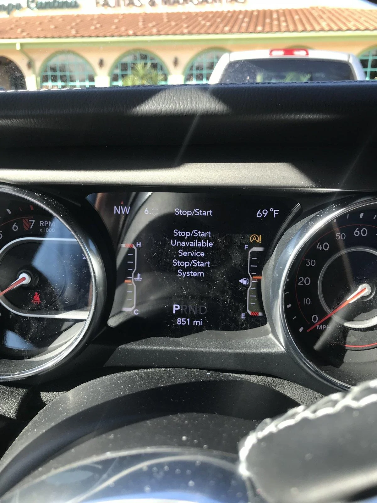

That is all good info. I took it back to the dealer after Christmas and they have not gotten to it yet. But since posting originally the check engine light came on, and the vehicle gave me a service start stop system. But the dealer said despite the check engine light, and my photos I had, they would have to reproduce the issue. But it only happens when you have been driving it for a while. It also only happens between 0-10 mph, and not while on the highway. The last time it happened we turned onto a busy 3 lane road, and it died. Then the system told us we had to put the car back in park, and then drive. Luckily the cars behind us slowed down. I just need the dealership to figure this out, because that is a safety issue.

I just got my Jeep Sport S back today with exactly the same symptoms you had, except mine completely died on me at 2700KM.
It turned out to be a bad alternator (although i've only had it back a day, so i hope this is the final root cause).
I think these symptoms are indicative of any number of electrical issues, all with the common result of a low voltage situation. I say this because while it was the alternator in my case, i have also heard people with the EXACT same symptoms having it resolved by replacement of either one of the two batteries, or re-seating connectors, or IBS sensors, or loose fuses.
Best of luck and please report back on the root cause. More info is better for everyone.
