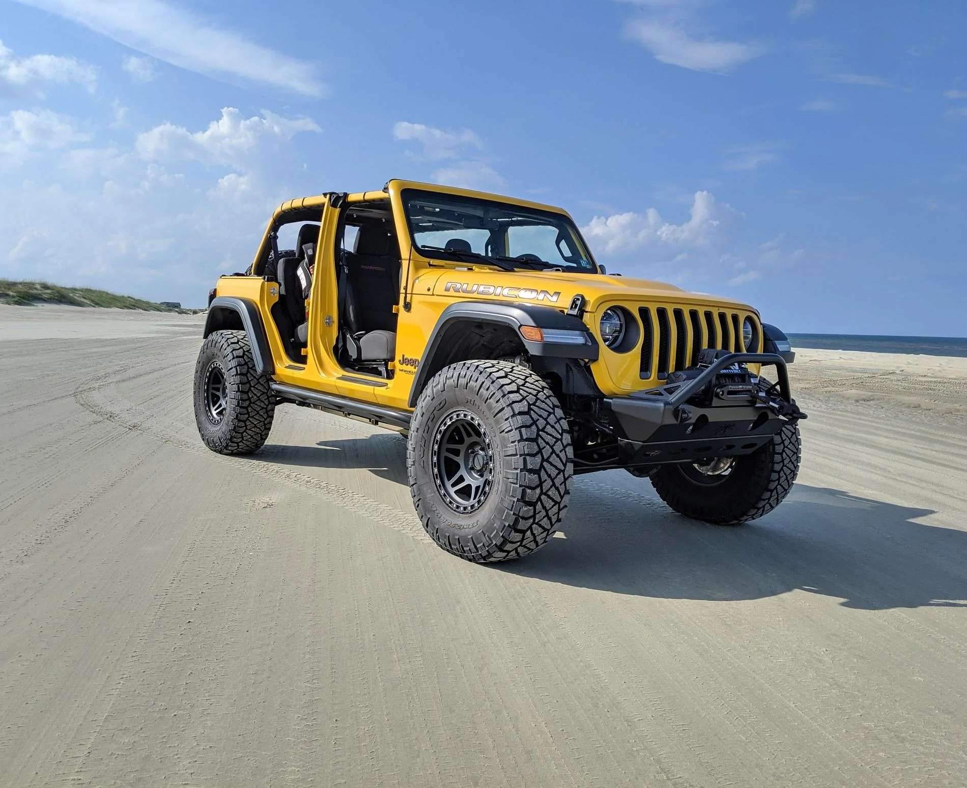

Spending the week in OBX

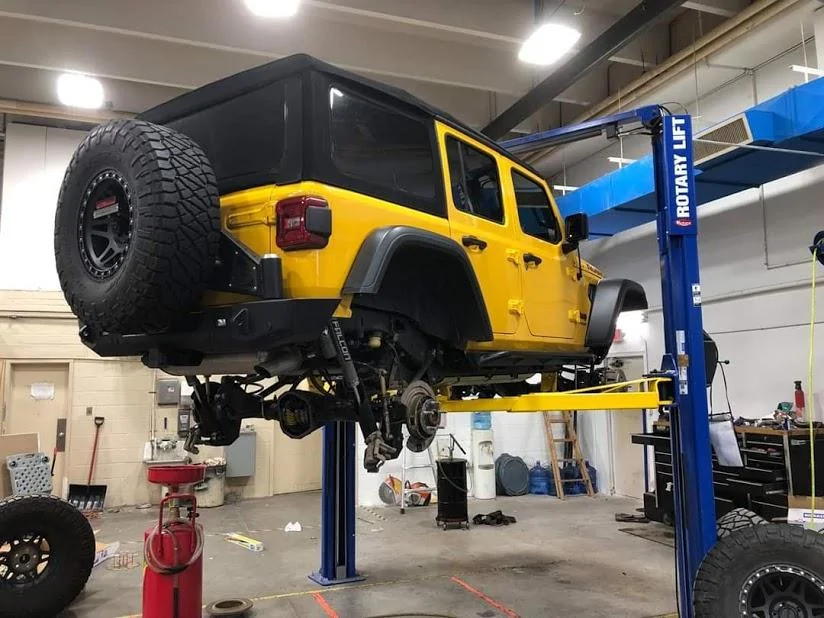

Beefed up my steering with a synergy tie rod, drag link, SS relocation and a fox SS. Definitely more stable and less flighty driving.
Removing the drag link end at the pitman arm gave me some trouble and took way longer than intended. Thankfully a bigger hammer and a pickle fork rental tool from advance auto got it off. Sadly... the drag link wasn't able to be saved :P

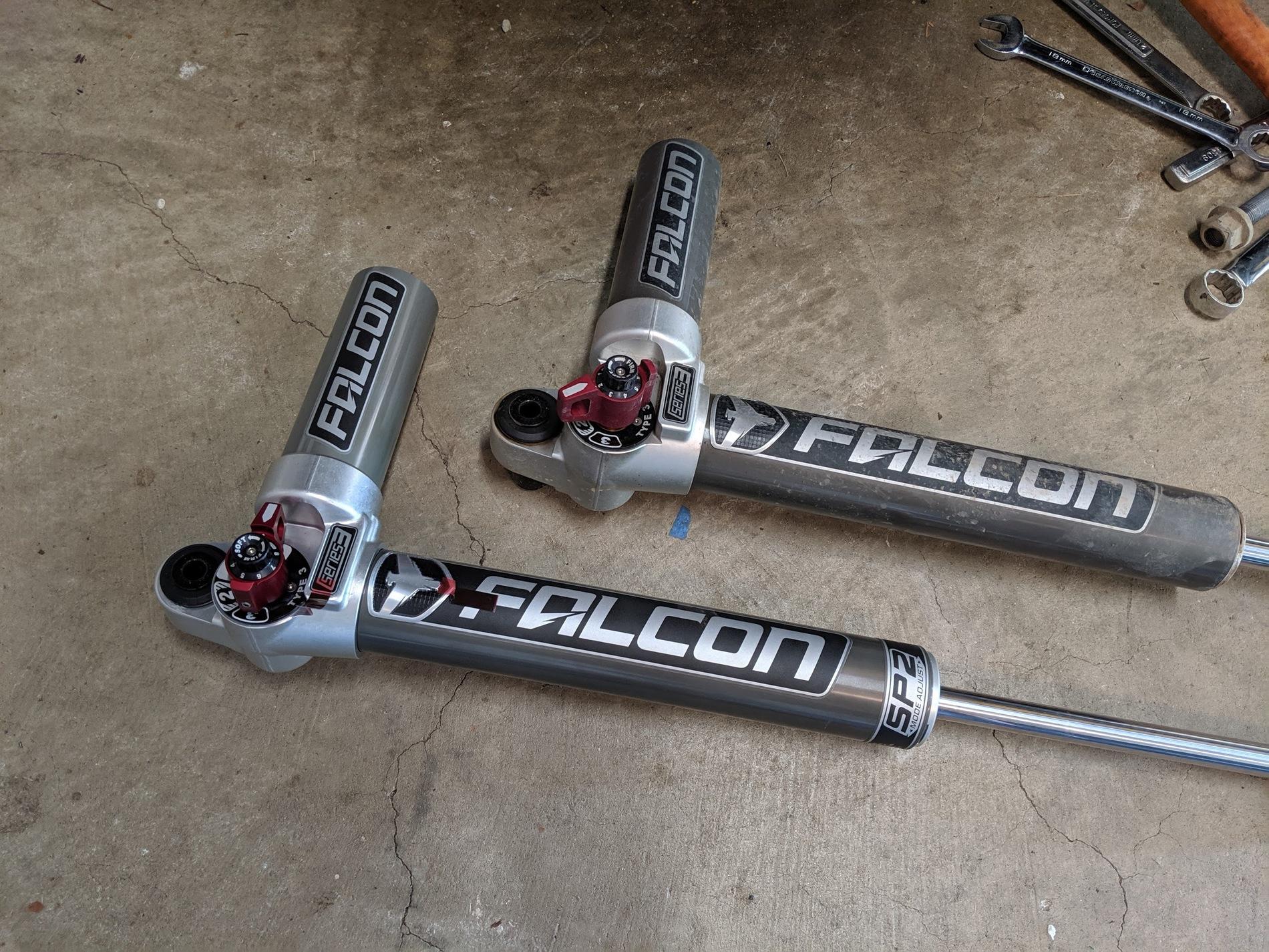

Upgraded to 3.3 SP2s, they're definitely noticeably softer compared to the original 3.3s

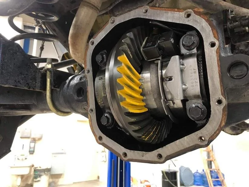

This past week marked my first year of ownership of the JLUR. Went and got it regeared to 4.88s. Picked it up yesterday and definitely noticed the difference. Consistently maintained 8th gear on my drive home. Really happy with the regear, can't wait to be out of the 500 mile break in period, to see how it really performs.
UKCATS
Aug 7, 2018
1,835
4,812
DFW
2018 Rubicon 2 door/2020 Gladiator Rubicon
I play piano in a whorehouse
“But, but, you don’t need to re gear a Rubicon.” It does make a big difference. Drives much better, tranny works like it is supposed to, and MPG’s actually go up.
