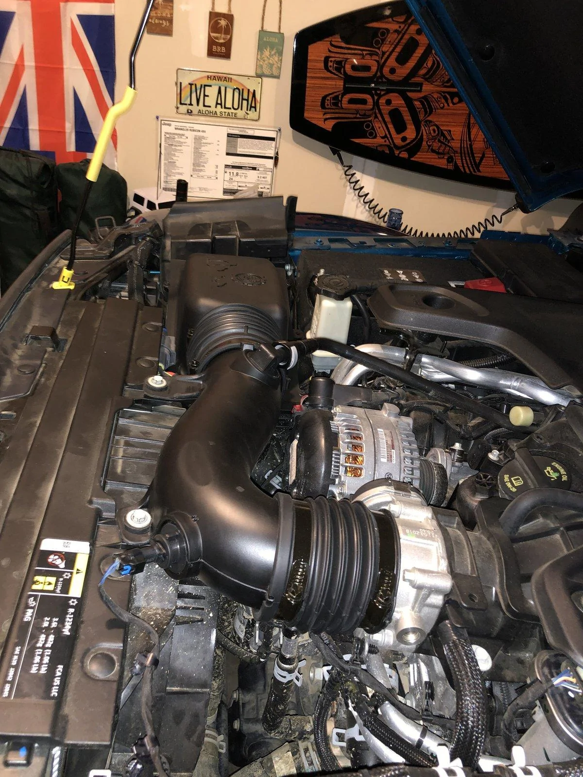

Mopar CAI (though this took until late October to arrive)

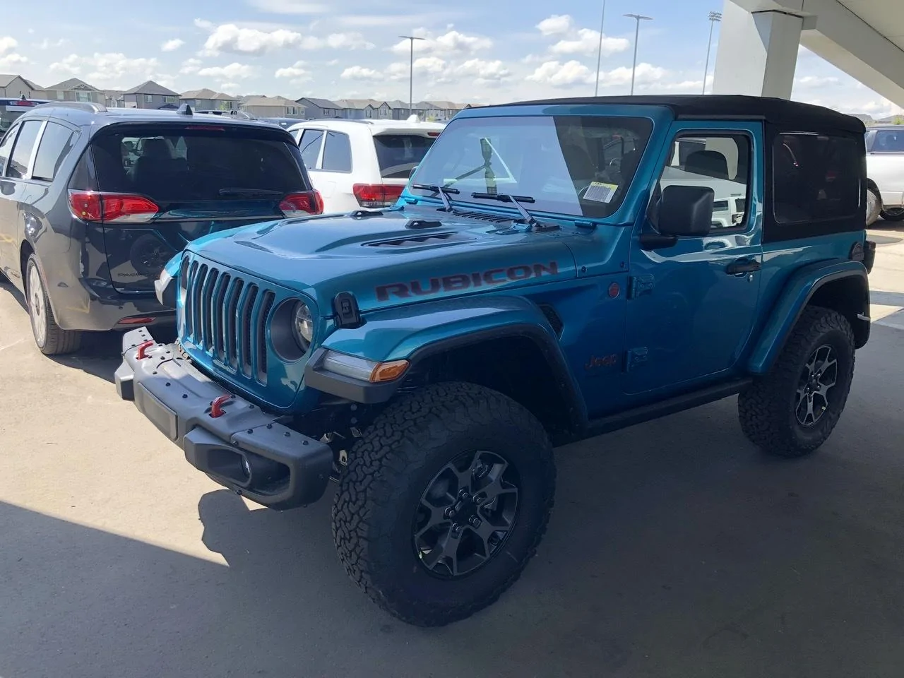

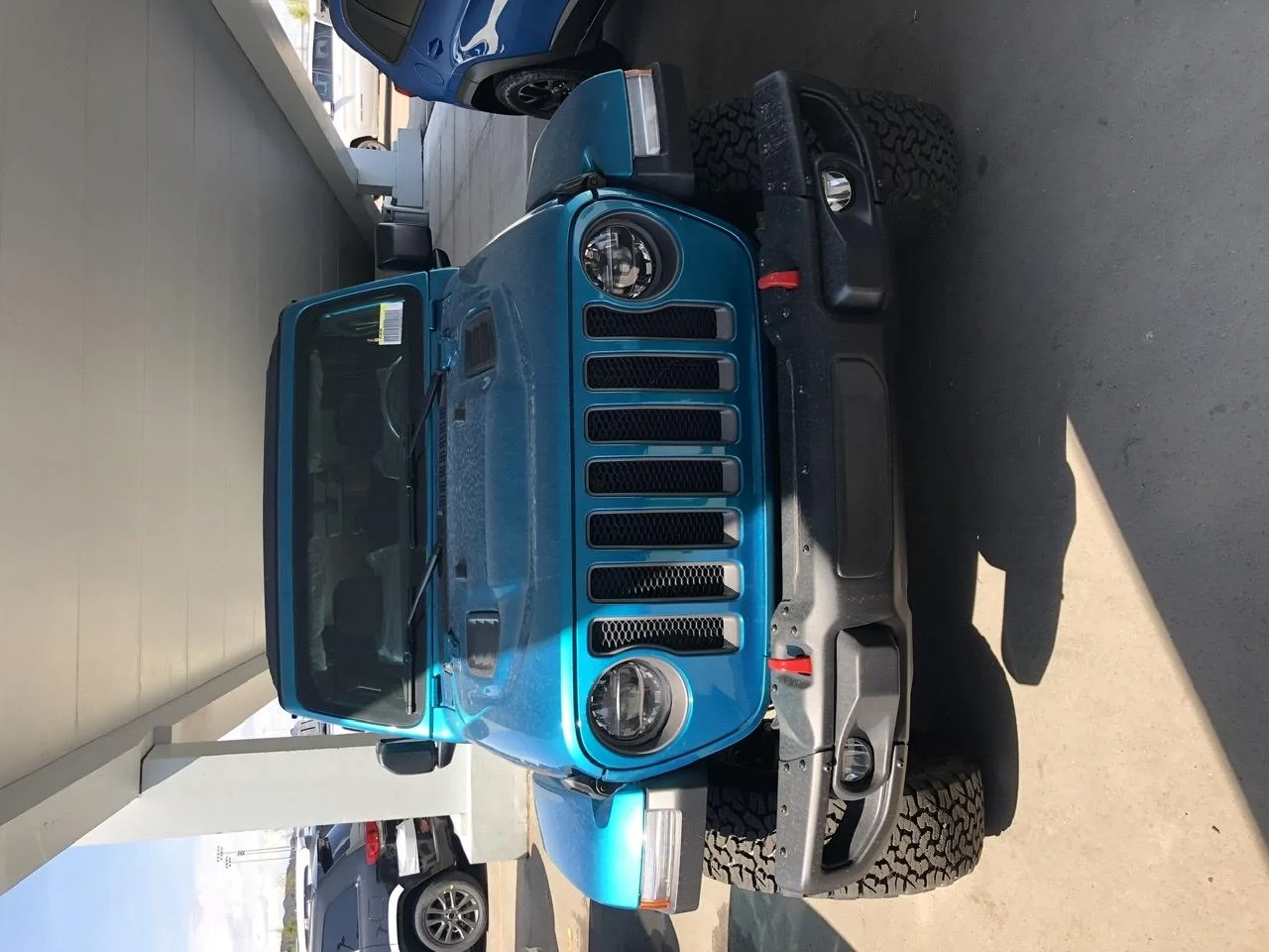

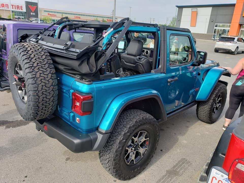

Fresh off the truck pictures first:
Jeep Wrangler JL 2019 2 Door Rubicon, Bikini - Discrete But Purposeful Build 810E07F1-F51E-4673-B032-51B7F0EEB7CA
Jeep Wrangler JL 2019 2 Door Rubicon, Bikini - Discrete But Purposeful Build 4BF71FCD-5E1E-47BA-B3D6-1D28F2DDA24B
Jeep Wrangler JL 2019 2 Door Rubicon, Bikini - Discrete But Purposeful Build 797E6DFF-345A-423E-B7EC-AA1DE6110F4C

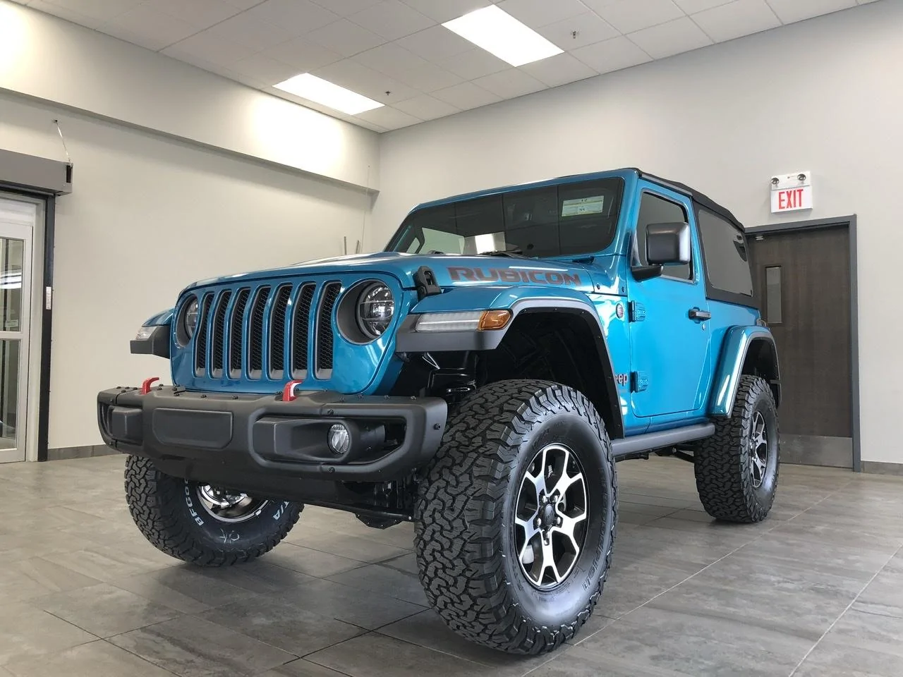

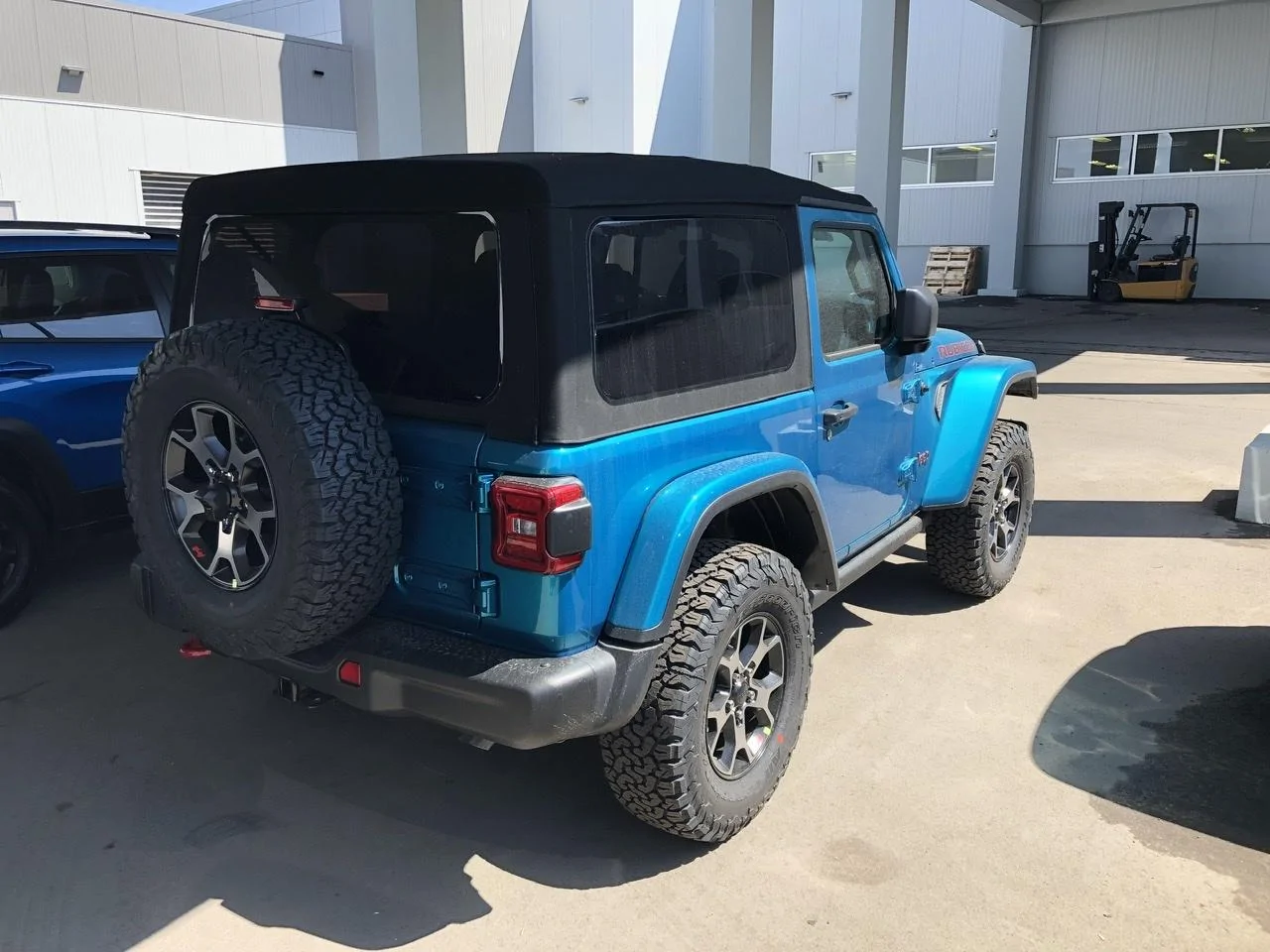

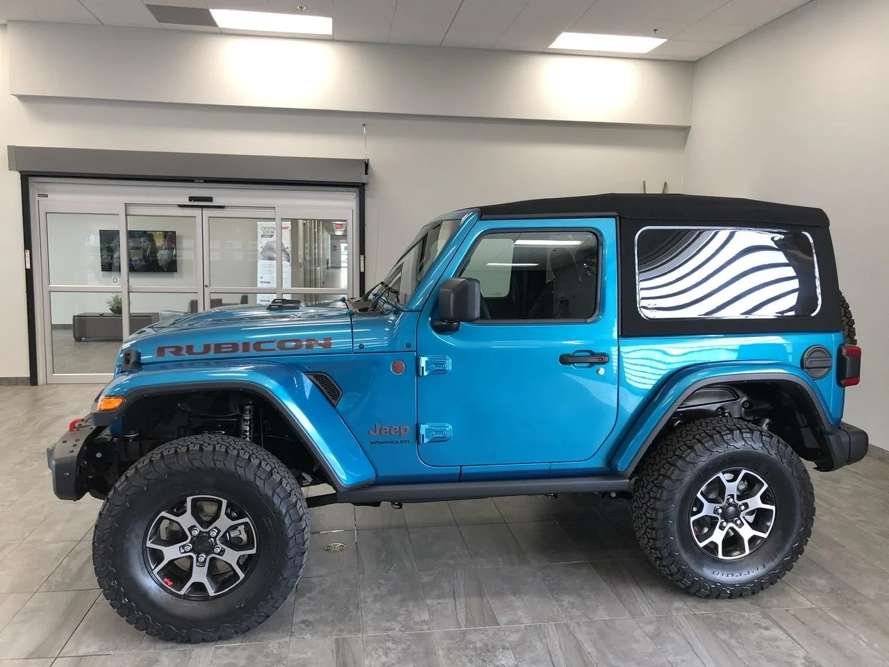

After the lift and tires were added - delivery day:

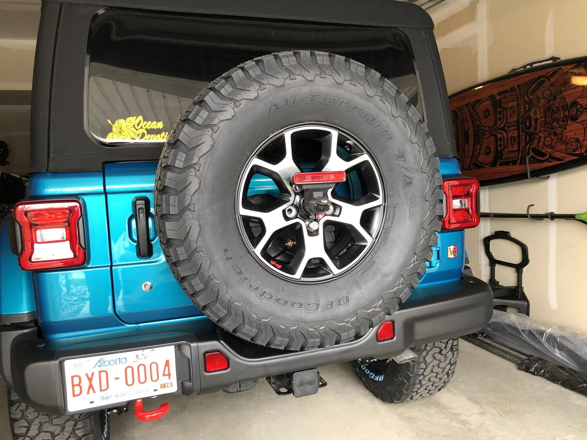

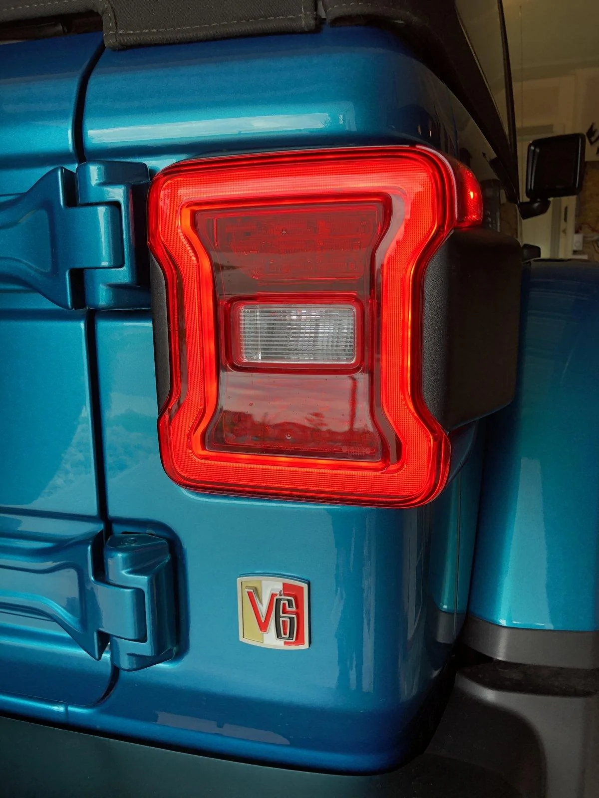

Waiting at home were a few mods (I had sold the mods off my last JK and recycled the money into this one) - first on was the Teraflex HD Alpha adjustable tire carrier......I had a ceramic coating booked for the day after and wanted to ensure they covered all the paint that would be exposed - the dealership had already been allowed to 3M coat the hood, grille, fender flares and windshield surround.
Had I trusted my gut and set the studs where I thought they should go instead of where the instructions said they should be the spare would have fit on correctly the first time of trying. Instead I spent a lot of time and curse words on getting the studs out and repositioning them. Aside from that it was pretty easy and a job I’d done before on my JK.
The only pic I took that evening was the after pic when I had calmed down and stopped swearing, lol.
Just for fun, since I’m going for a bit of a retro vibe with my build I put a repro V6 emblem from the CJ era.

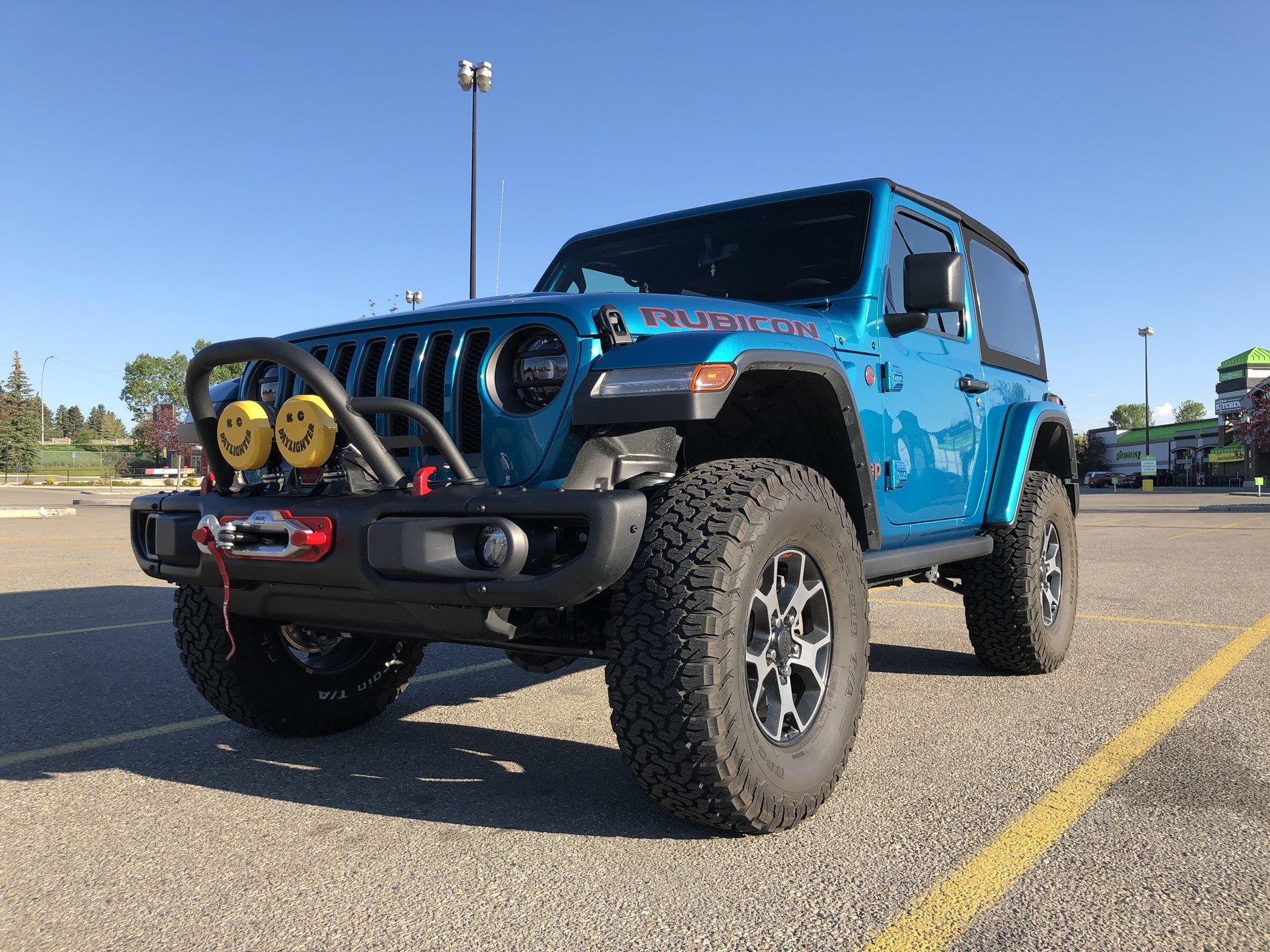

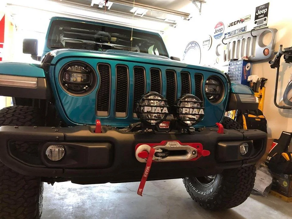

The following day I prepped for the winch install and in short order put on the winch hook plate (Maximus3), fairlead, light bracket (Maximus3) and my old set of PIAA LP570’s. The following day I was set to go to a club members place and get some help installing the winch...more on how well that went in the next post...
I also figured that was the best time to pop the grille off and install the headlight guards (Rugged Ridge).
Looking at my pictures I see that I also put the Molle seat back bags on - these are no name, EBay specials but seem well made and cost a fraction of the Mopar ones.
JPAloha
JPAloha
Sep 21, 2019
1,019
3,201
Calgary
2019 JL Rubicon 2 door, 2022 JL Rubicon 4xE
Accredited Financial Planner

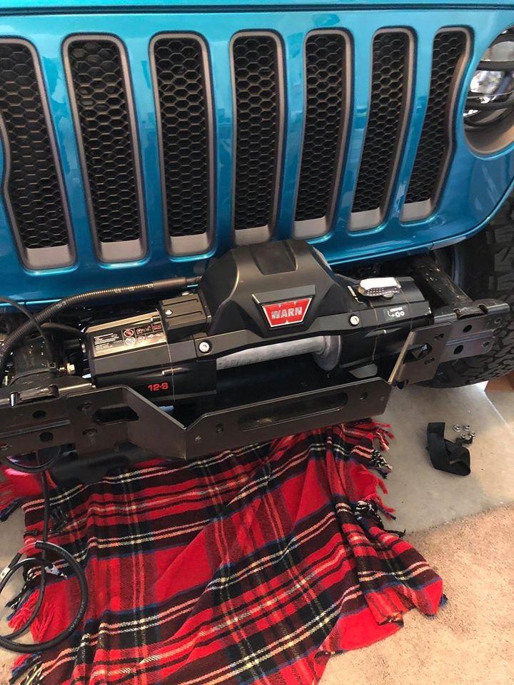

Ah the winch install.......it looked easy on YouTube, it should have been easy as I had someone helping who had done many winch installs before (I had never done one before)...........
Yet, somehow, it took us forever and the winch itself didn’t seem to want to go in. We tried a couple of times but it didn’t want to co-operate so we convinced ourselves that it was too big to go in place. The YouTube video guys had all put in a 10-S, the 12-S must be bigger...right?? Wrong!!
I drove myself crazy tracking down dimensions, triple checking them, watching those videos over and over - how could it just drop in for them and not for us?? Well I decided to have a go myself, took the bumper off again and rather annoyingly...it just dropped into place!! To this day I’m not sure if I was more excited or annoyed....lol.
Then there was the small matter of getting the winch line installed onto the hub...I wasn’t sure if I needed to take it to dinner first, buy it some flowers perhaps...it just didn’t want to let me pop it into place...in the end a bit of brute force and ignorance got it to a point that it was seated “well enough”.
Once it was spooled up and the cables routed through the engine bay it was time to put the bumper back on...it was fiddly but ok and then just a case of stripping my knuckles as I tightened the bolts...realized I had to loosen the winch to move it to tighten up the inner bumper bolts, curse the SOB who thought this was a good way to assemble everything as I figured out the various tools I now needed to bolt the winch back down with a bumper in the way and then realize I had to do it all over again when the stinger finally arrived some weeks later.

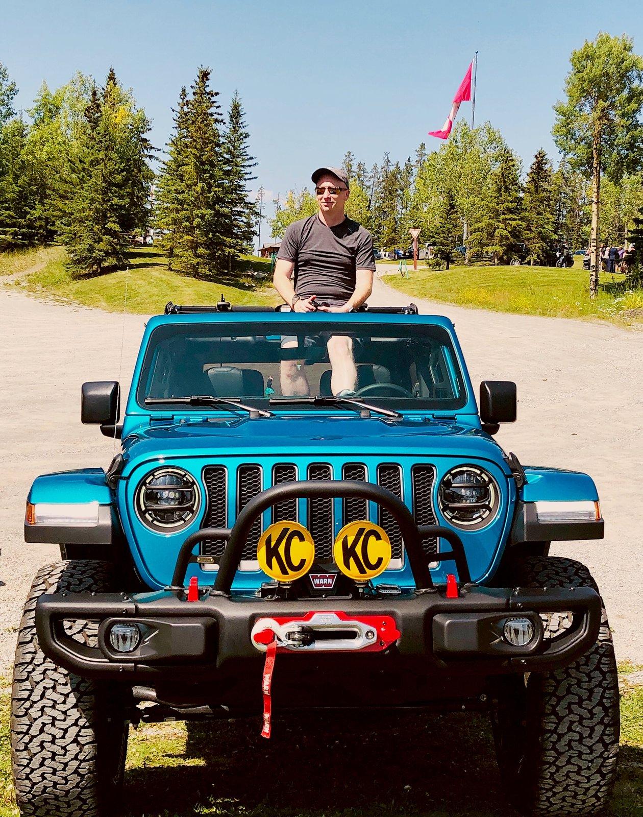

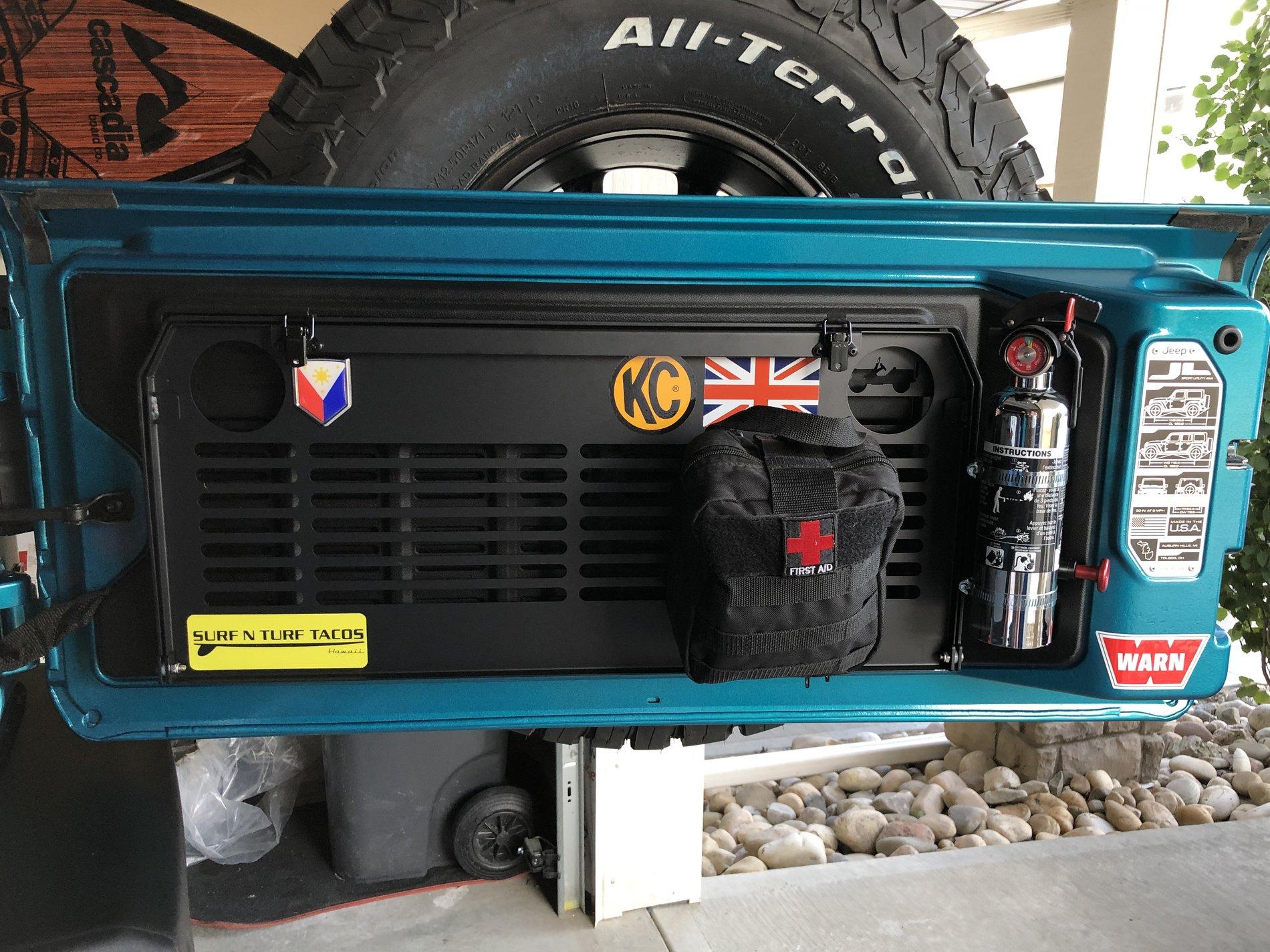

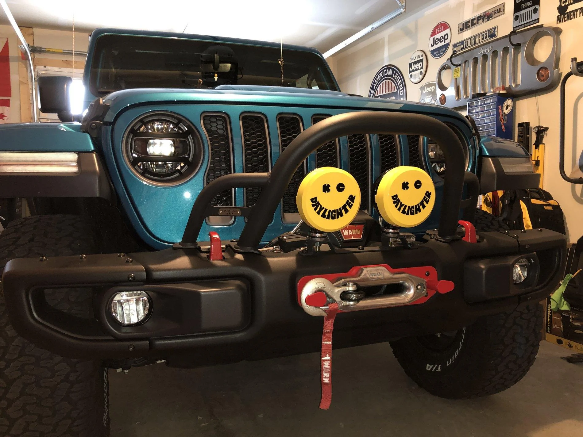

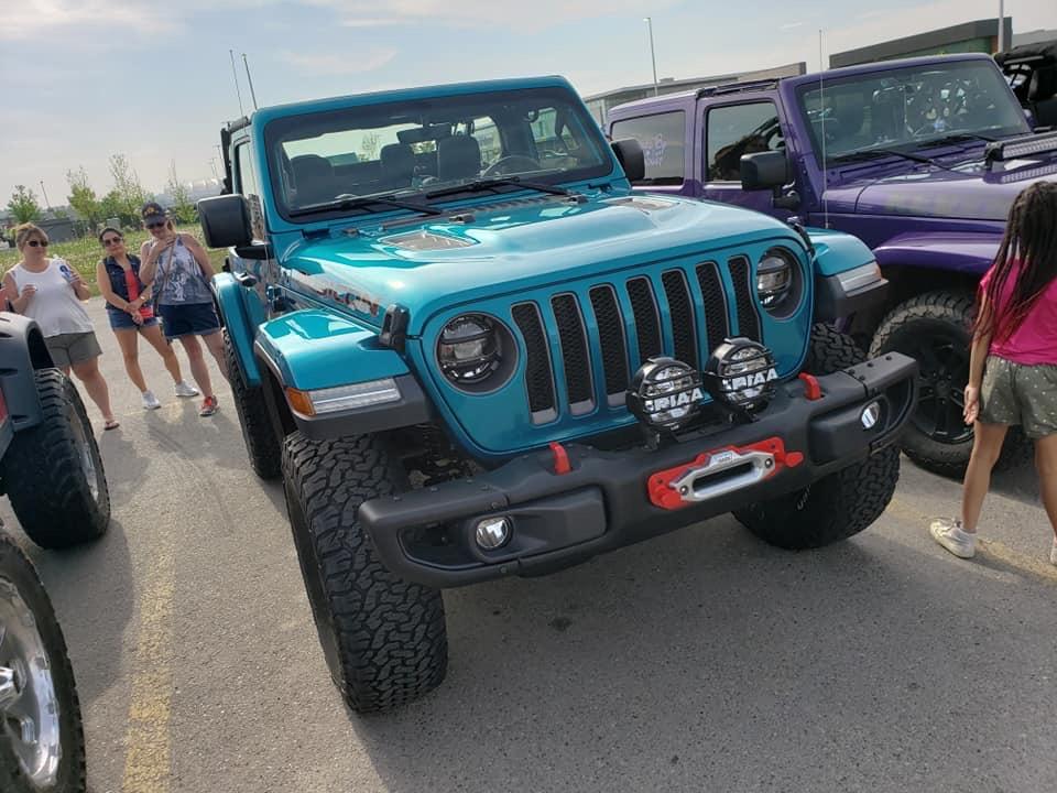

The next few changes happened in a little blitz of activity...the stinger finally arrived as did the filler plates to around the winch (both Maximus3), oh the joy as the bumper had to come off again and then did not want to go back on as the inner and outer pieces had somehow come out of alignment and that meant it did not want to rejoin the rest of the Jeep - it was such a pig until I realized what was happening and that an extra pair of hands was needed so it could be persuaded to work.

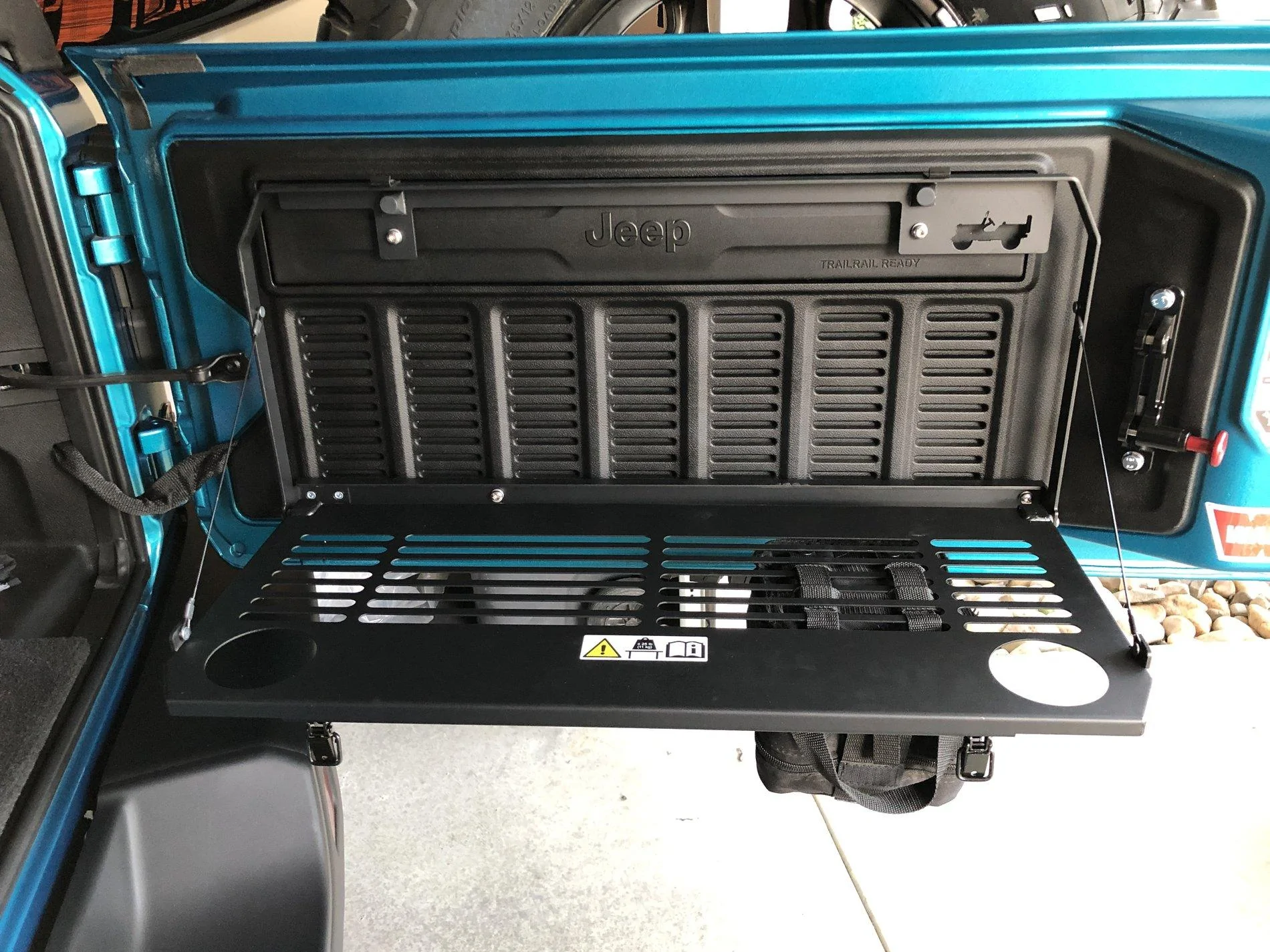

The tailgate table went on, with zero issues - by far one of the easiest things to do...I had actually put the fire extinguisher mount on a few days prior to the table and realized the extinguisher has to be removed from its bracket before the table can be dropped.....learn from my mistake and do it the other way around...thankfully it’s a quick release mount so not a big deal for me to live with. I also used the table as a Molle mount for the first aid kit so the emergency equipment is all in one place.

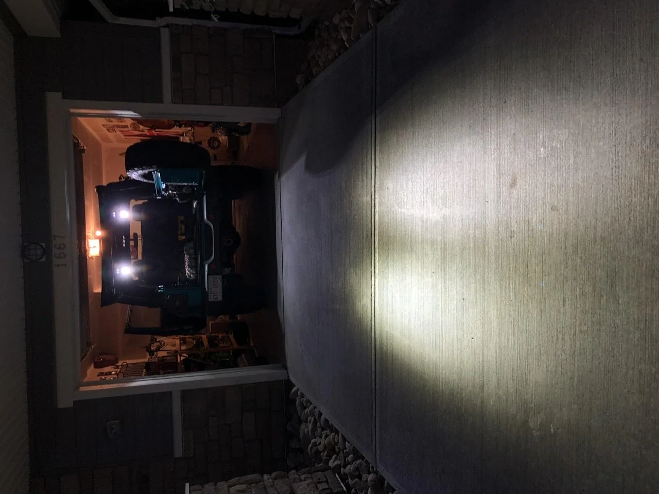

The PIAA’s made way for a set of LED Daylighters to give more of that retro vibe that I’m going for...

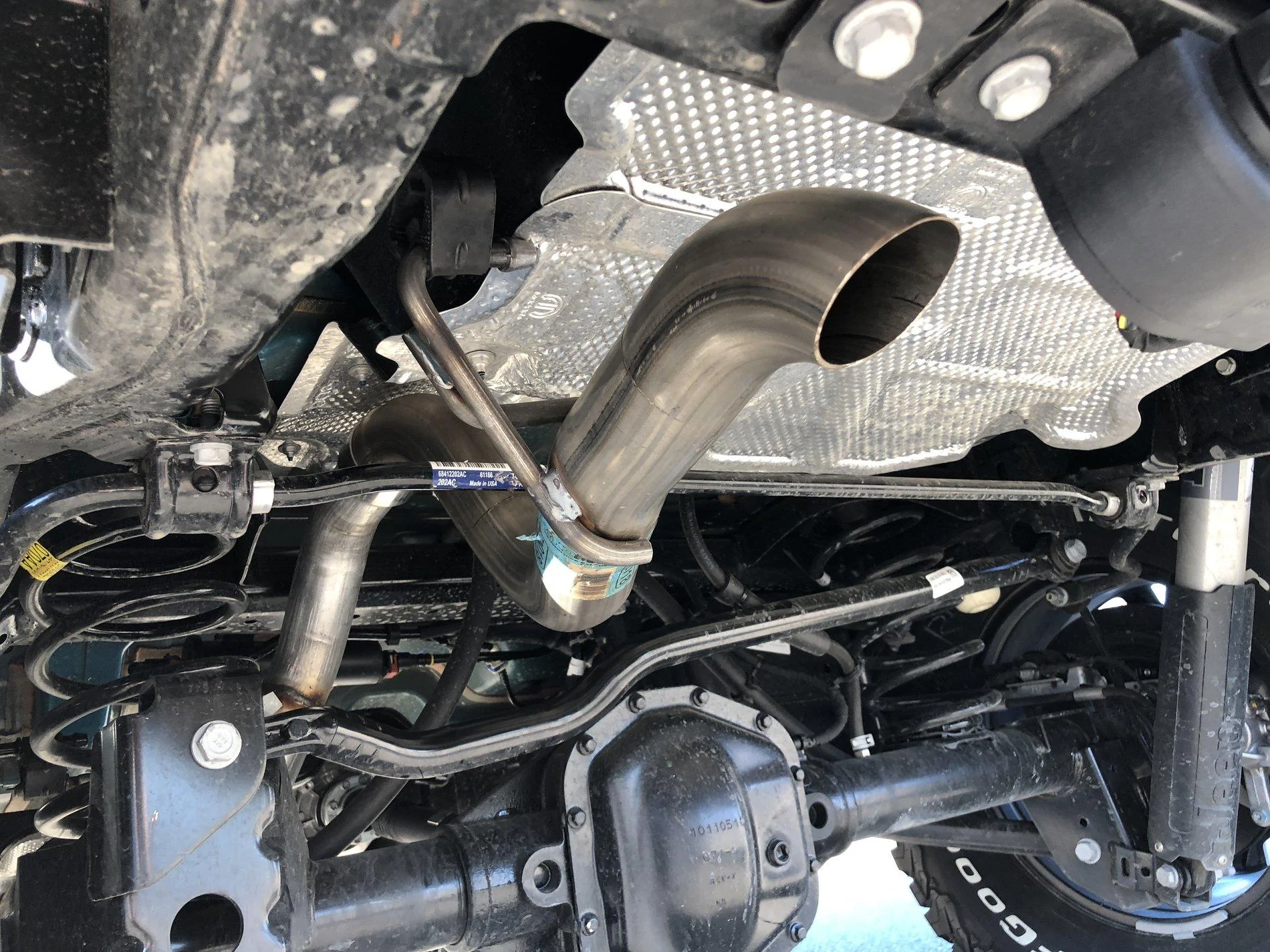

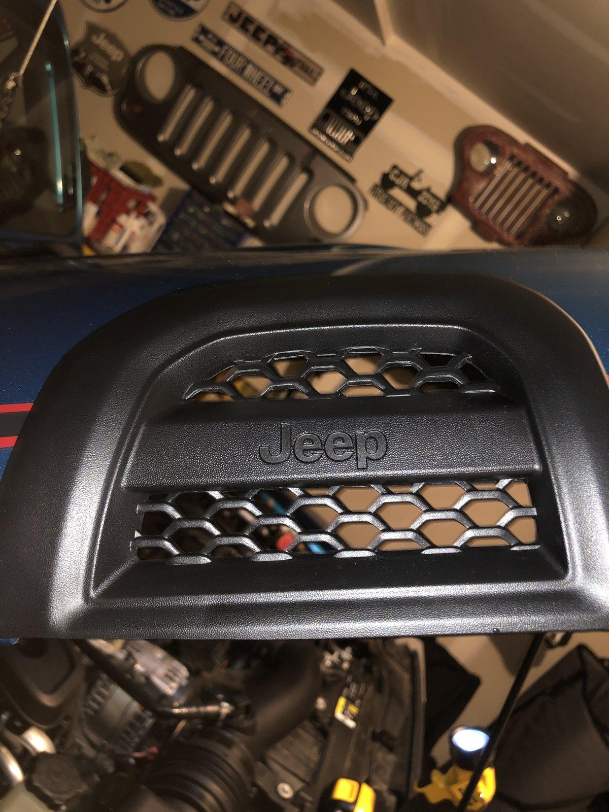

...and the factory muffler came off and was replaced by a Dynomax muffler delete. Primary reason was to gain a bit more ground clearance, secondary reason was the sound and (if it exists) bit better breathing for the engine...

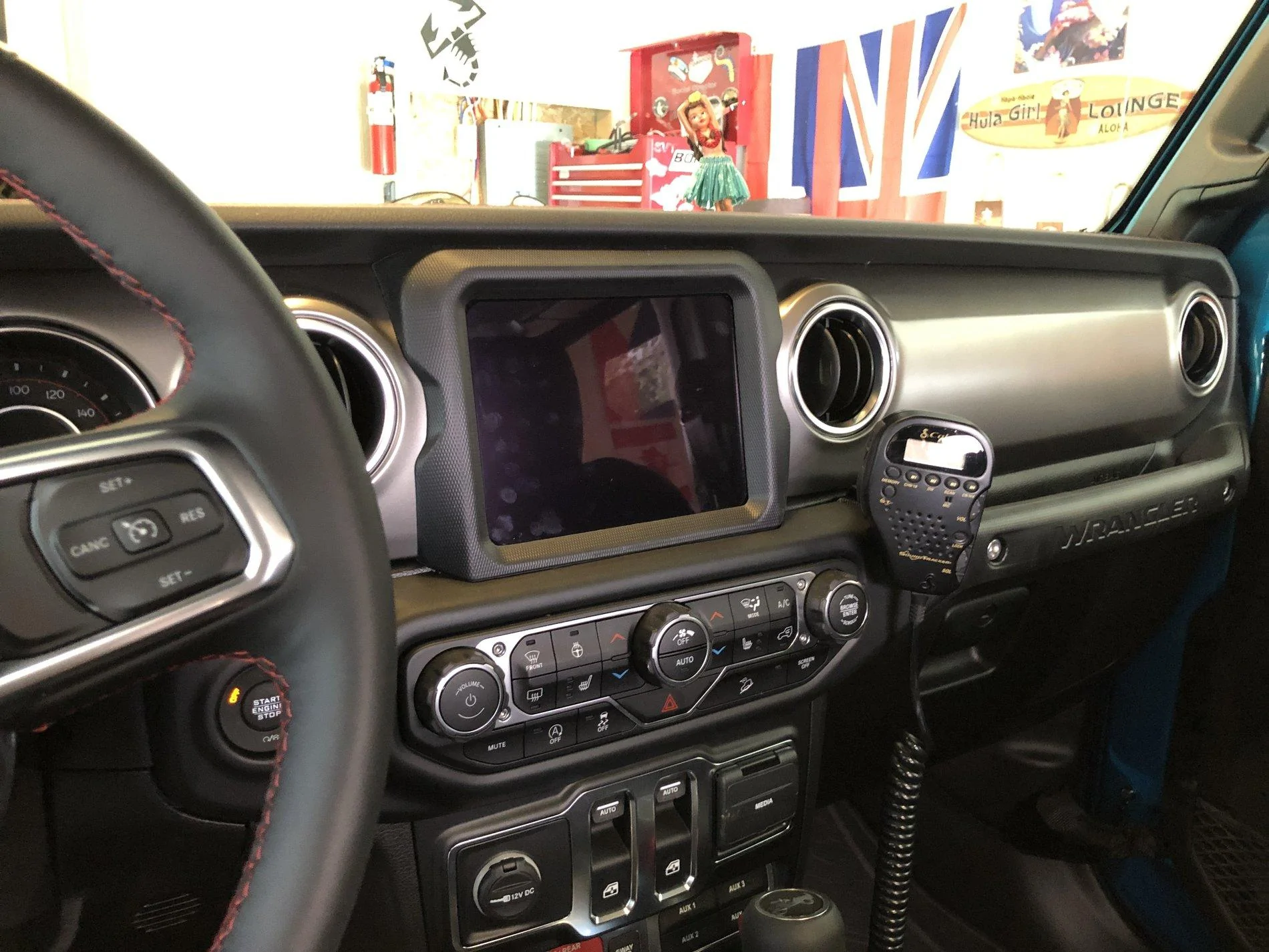

Installing the CB - I had kept my Cobra WX-ST 75 from my JK but needed a new antenna mount (Cooltech) and microphone mount (another no name EBay special that works well). I did replace my 4’ tunable firestik with a 3’ hoping it would clear the garage but it sits a hair too tall even if I removed the quick release mount for it...on the bright side the 3‘ antenna fits very nicely across the rear of the back seat, held in place by the Velcro straps that Jeep chose to put on (for reasons I have yet to figure out).
Adding taillight guards to match the fronts, RR had taken their sweet time to release them but they were easy to install, look good and seem like they would offer some protection to those expensive LED’s in case they brush against something unfriendly.

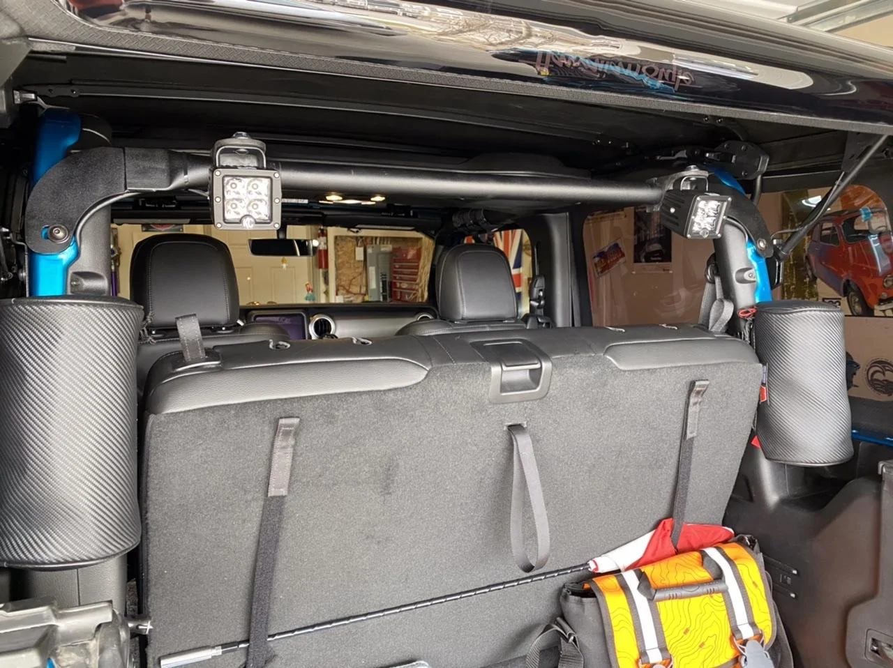

I had placed an order with Quadratec to be delivered to Montana as we had planned a quick weekend away south of the border. This had what I can only call mixed results. Everything came, exactly as ordered but we revealed some issues with the descriptions on the website regarding fitment...everything was either generic or stated would fit a JL...
The generic parts fit, of course....just some Warn rollcage bags so a non issue...

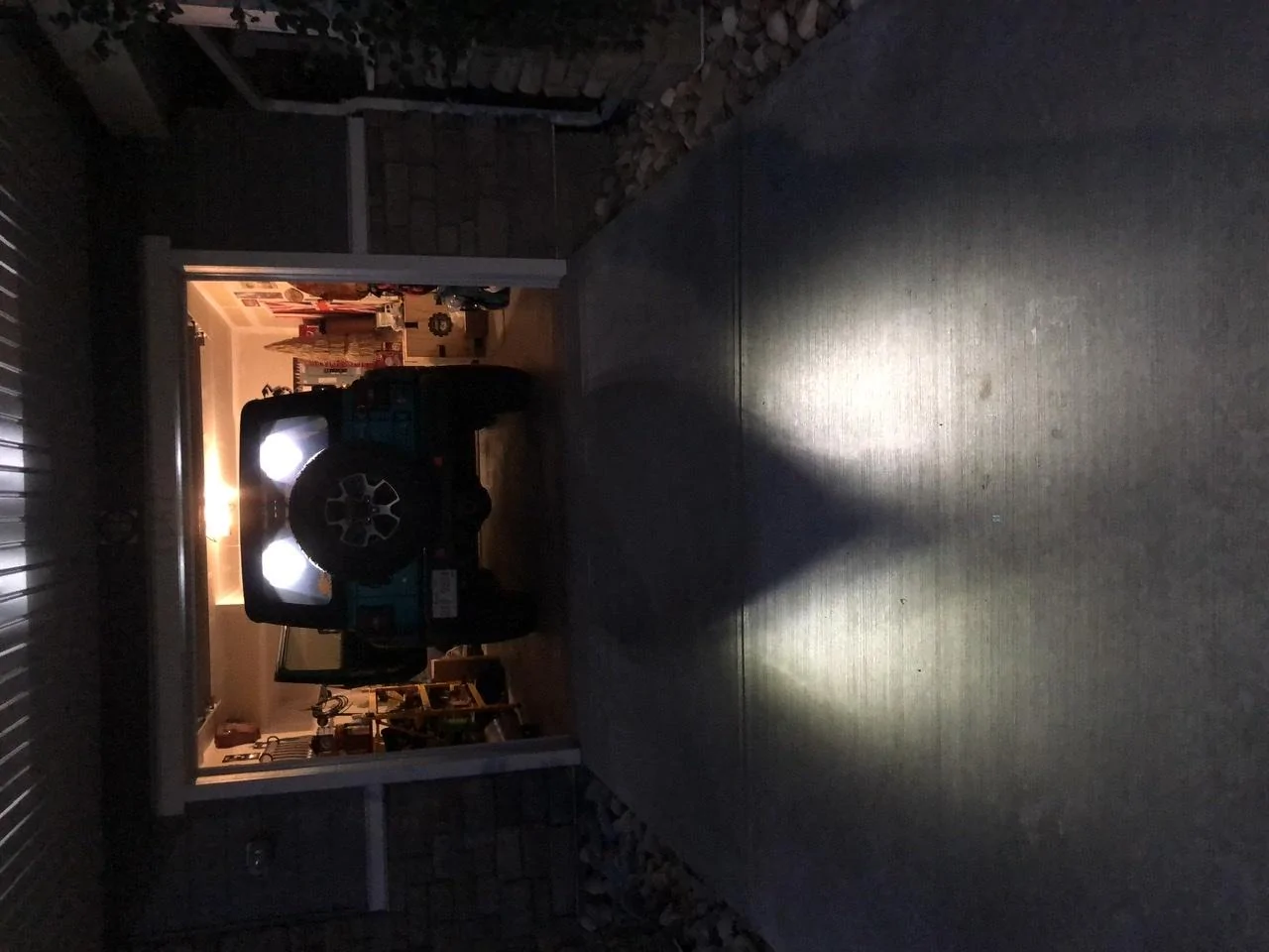

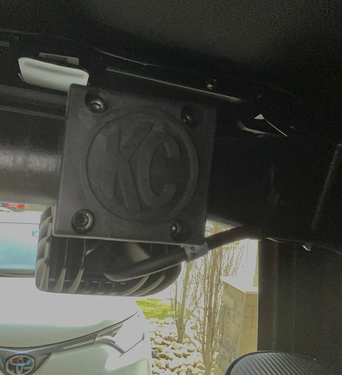

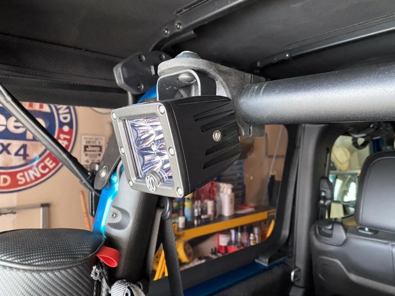

The rest well...less luck there....the Fishbone off-road rear flashlight holder did not fit a 2 door despite what the listing said at the time (it reads as JLU only now after my review...which they deleted...). The same luck with the Motor City Roll Cage light mount - though with some stubbornness and a drill I expanded the holes and made it fit (I left a review on that one too, also deleted, that saw the listing corrected).
That said I like the roll cage light mount and have a pair of KC C3’s mounted on it to help provide light on trails or just to remind people that are tailgating that I don’t approve :).
