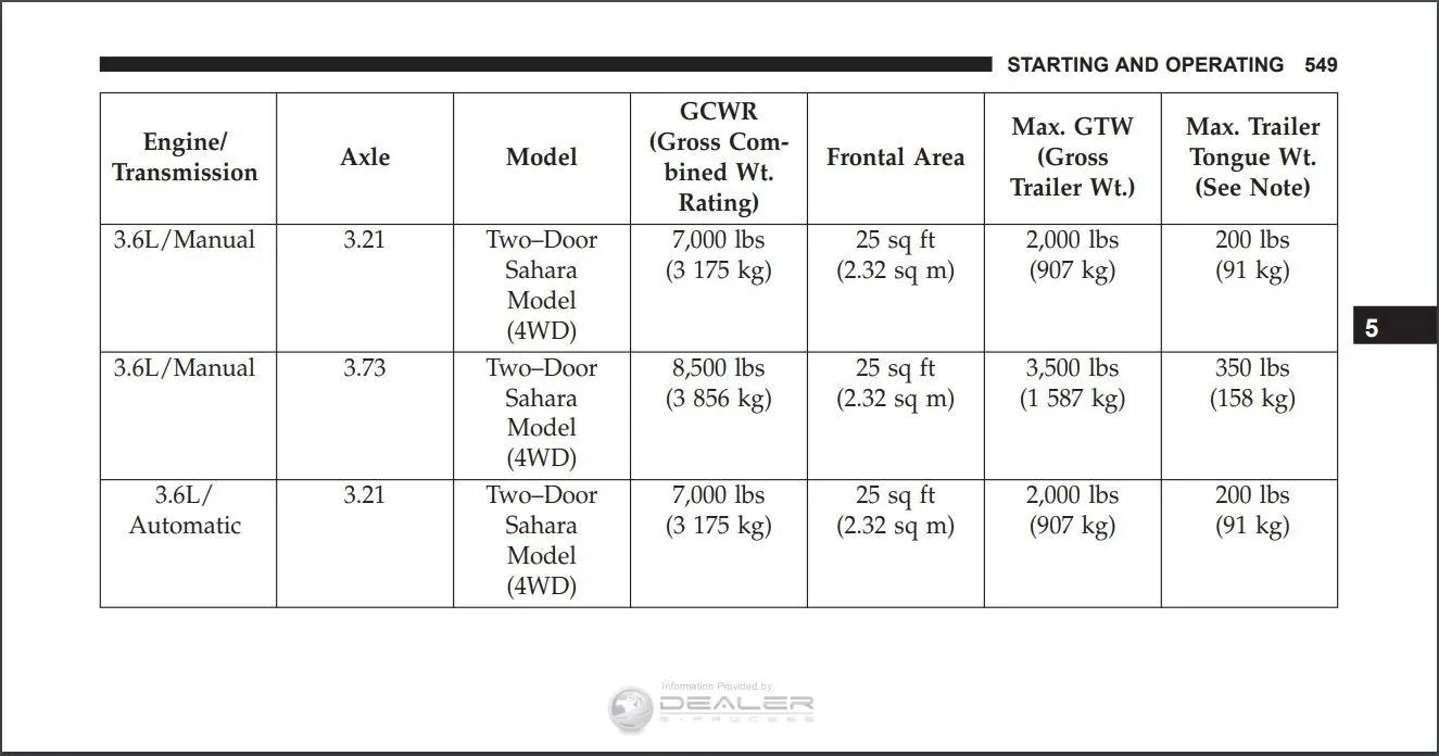

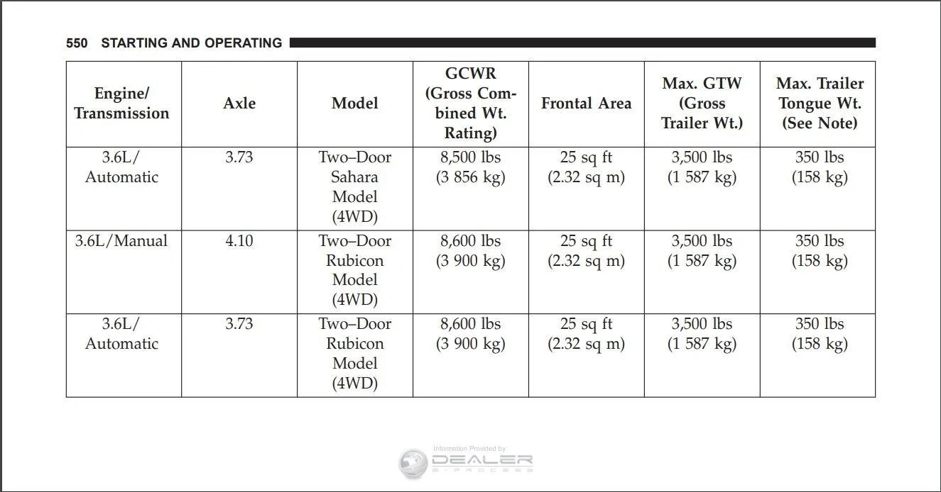

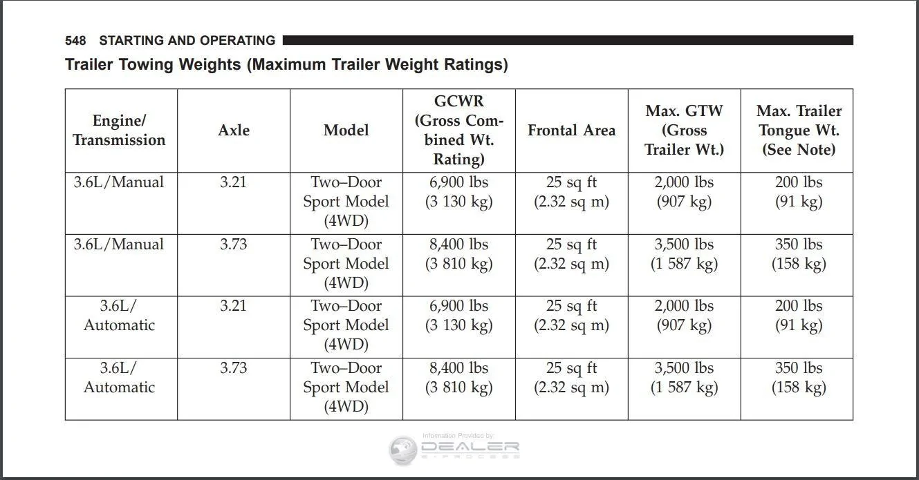

Was that actually true though? Did the specific owners manual for those with that gearing actually show 3,500? I have seen that listed on the web, but found nothing official from jeep on that subject.The 2016-18 JK 2-doors were rated at 3,500 lbs towing with either 3.73/4.10 gears.

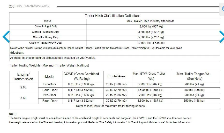

Not sure why FCA dropped the tow rating for JL
Yes, it was published in the owner’s manualWas that actually true though? Did the specific owners manual for those with that gearing actually show 3,500? I have seen that listed on the web, but found nothing official from jeep on that subject.
Interesting. I haven't looked in my manual.. but I have the 2020 2 door wrangler sport S with trak-loc. It gives me the Rubicon rear end, but I still think it is a 3.45. I will have to go look.Yes, it was published in the owner’s manual

Yes, JL has 3.45 gears. While you have a “Dana 44” rear end, it’s not the same as Rubicon.Interesting. I haven't looked in my manual.. but I have the 2020 2 door wrangler sport S with trak-loc. It gives me the Rubicon rear end, but I still think it is a 3.45. I will have to go look.
What is the ratio of the Dana 44?Yes, JL has 3.45 gears. While you have a “Dana 44” rear end, it’s not the same as Rubicon.
