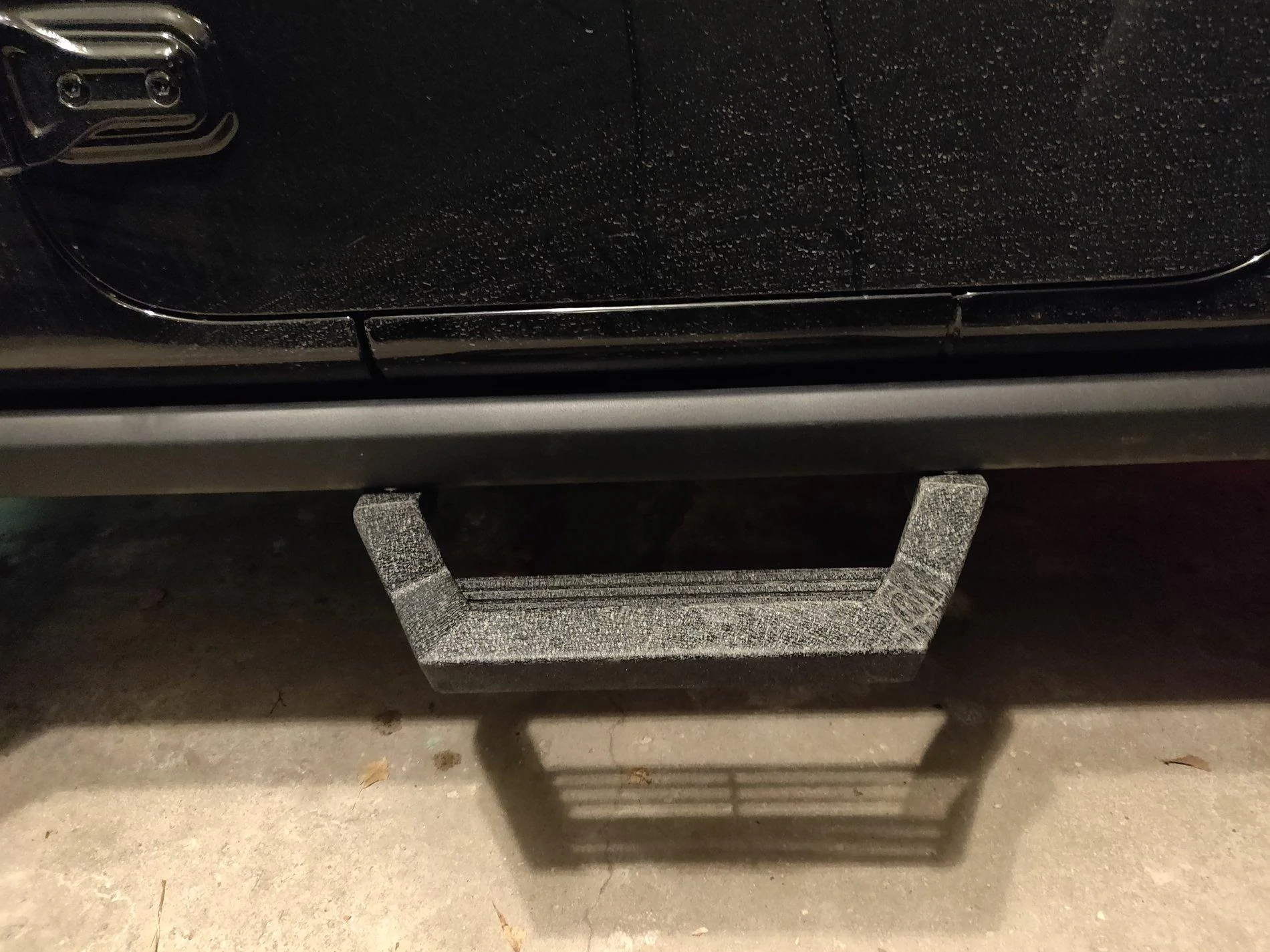

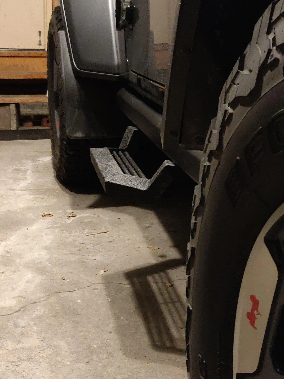

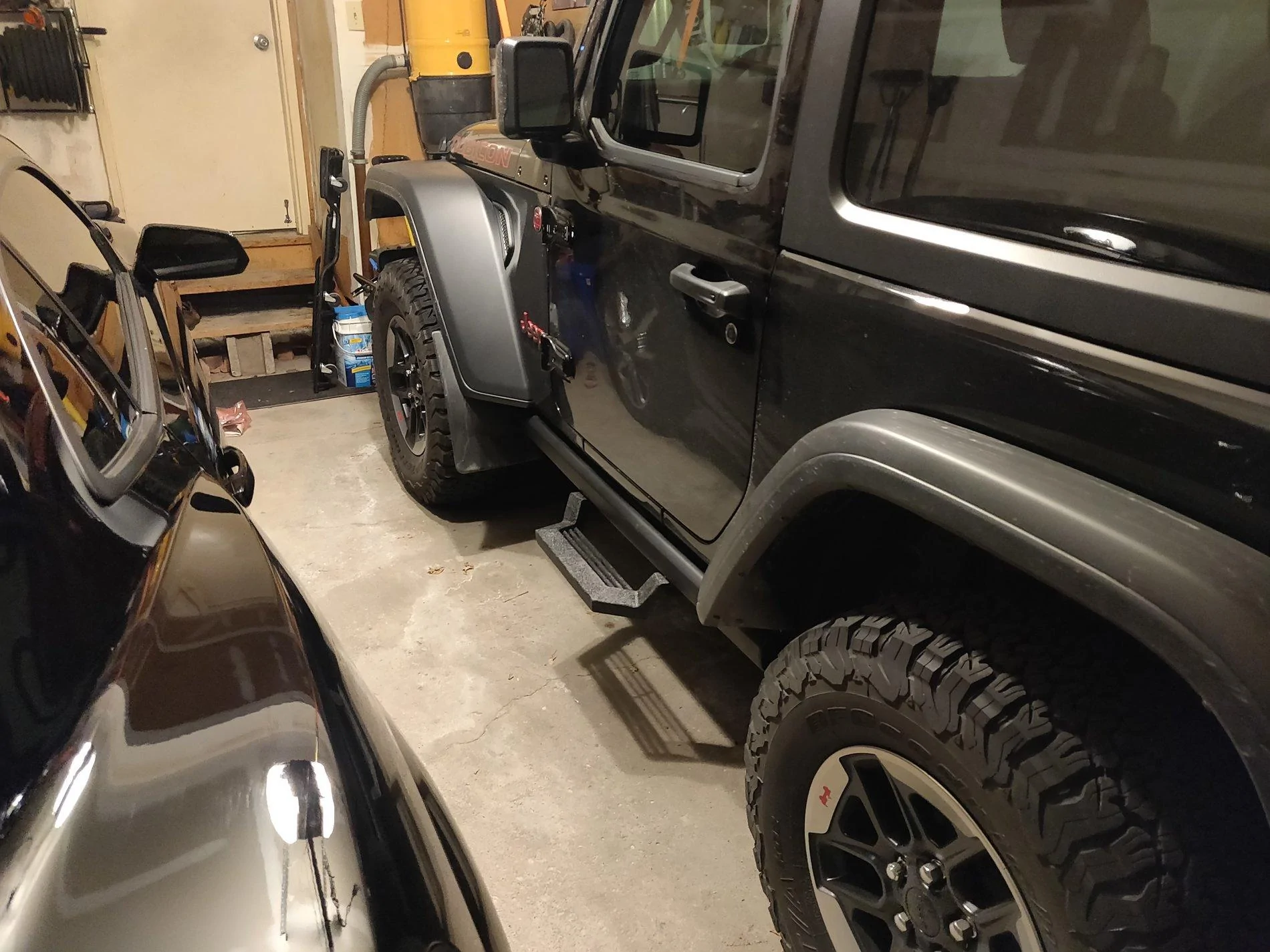

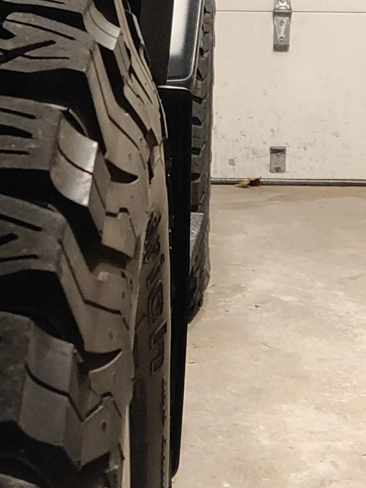

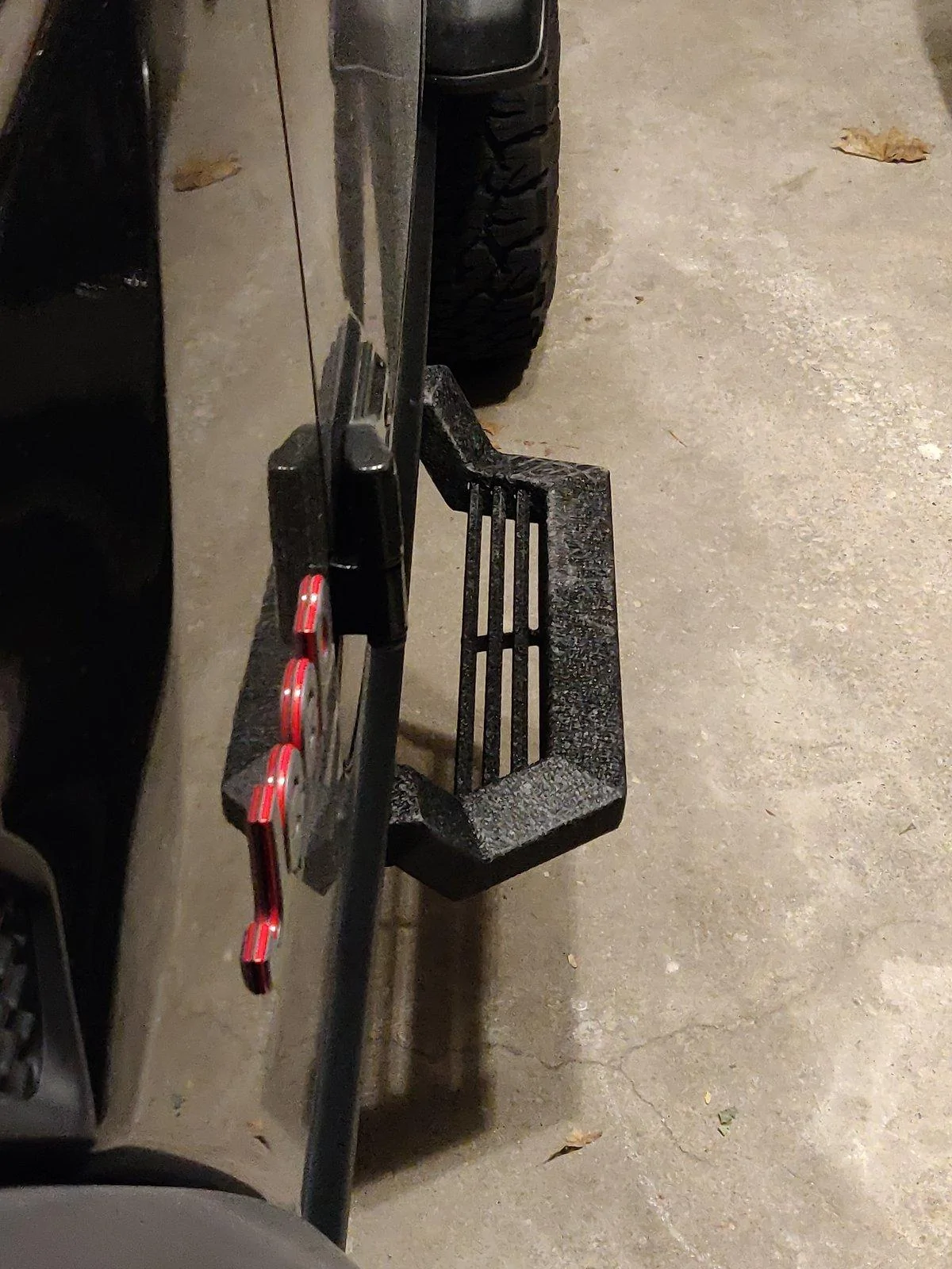

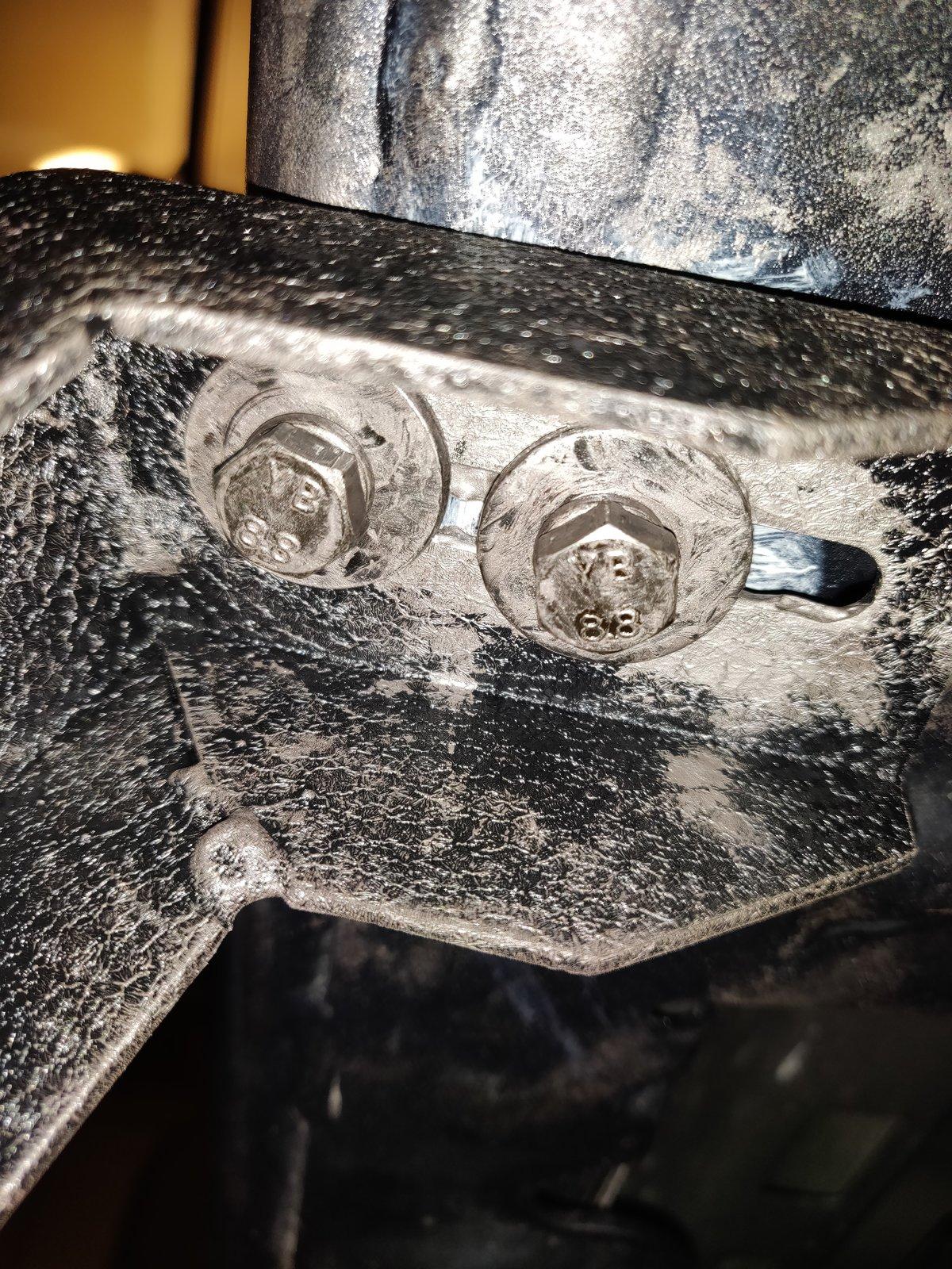

Hey Miscle_cars_only, if you have the Rubicon Rock Rails, and just want just a simple side step, you could try the Lund, Steel Short Step for Rock Rail (P/N 26410025). They were dirt cheap on Amazon (under $100 Canadian, taxes and shipping included), took about 3 hours total to install from start to finish, and can be removed by undoing 4 bolts per side. Removal takes less than 5 minutes per side now that they're on.
Installation was pretty straight forward;
- Measured and marked out where I wanted the steps
- Drilled 4, 11 mm or 7/16" holes into the bottom side of each of the stock Rubi Rock rails
- Installed an M8 Stainless Rivnut into each of the holes
- Bolted the steps on with the included Grade 8.8 bolts, washers and lock washers
This may not be everyone's cup of tea, but I like the fact that they can be removed in a matter of minutes, and they didn't cost an arm and a leg!
