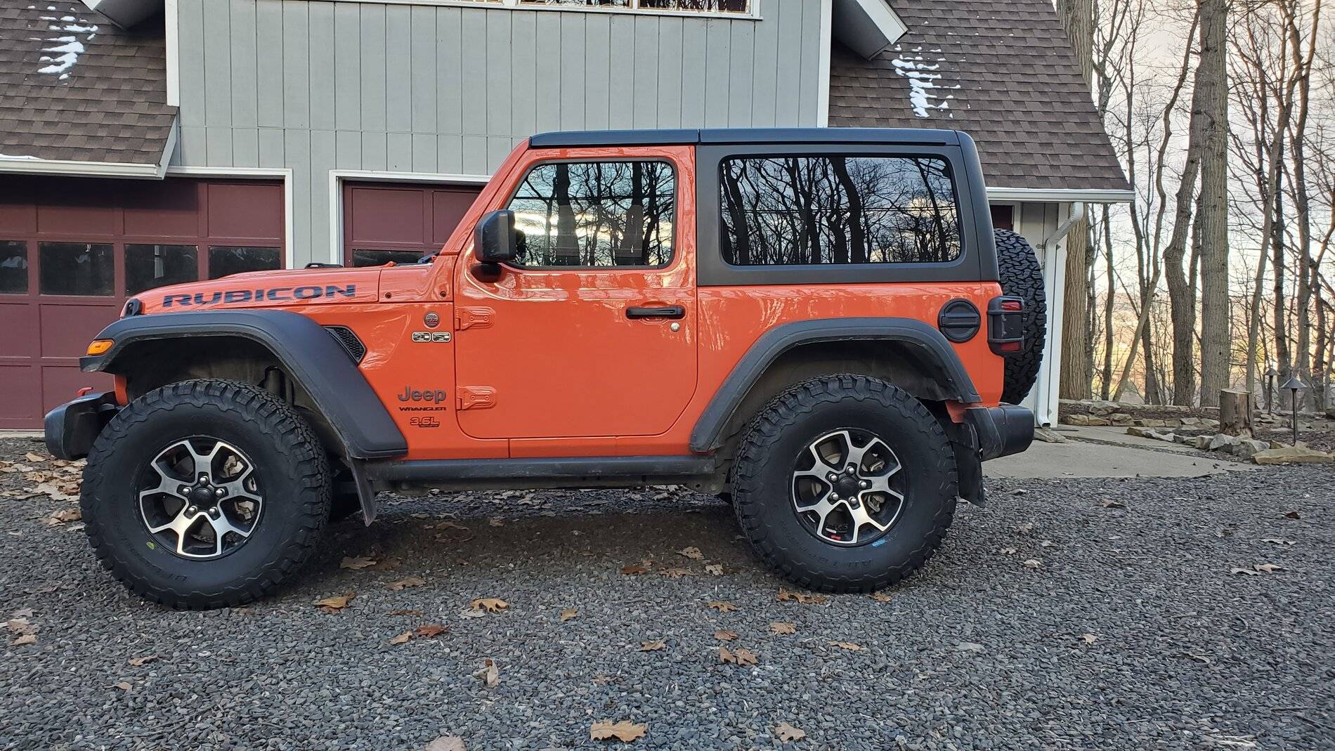

It sits pretty level. If anything, the rear may appear a little lower which may level it out when I add a winch.(Different from my 4Runner that was a little lower in the front..)

It will be mostly level from the factory, maybe a slight reverse rake like Jeff's above. If you put anything heavy on the rear it will be much more noticeable. It was enough that it drove my OCD nuts after I added a heavy rear bumper/tire carrier. Even with steel bumper and winch in the front, and no back seat it wasn't enough to offset it and my Jeep had a saggy butt for a while.
When I installed the new shocks and springs everything leveled out and I didn't need to add any spacers.

Mine is high in the rear because I removed the hardtop and rear seat, moved the spare into the bed and added a winch. Like @pangmaster said, it's going to be pretty level from the factory. From there it depends on what you add or remove.

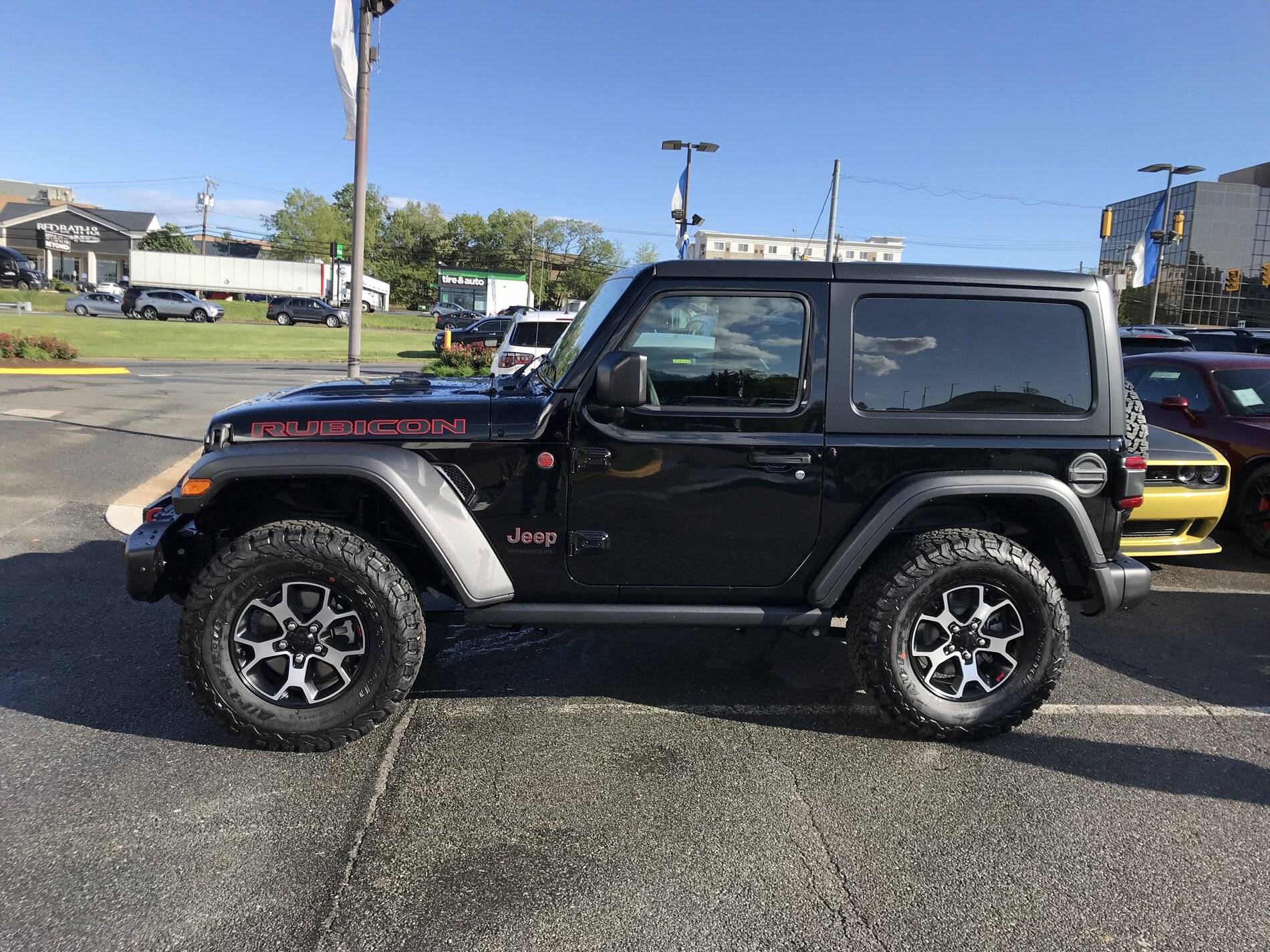

The 4D sits lower in the front than rear (rake) and the 2D sits higher in the front than the rear (reverse-rake). This is for the 3.6L V-6. I don't know if it is different with other engines.

My JLR sits fairly level as stock. There maybe 1/4" drop in the back, but I haven't measured. It could also be an optical illusion because the fender flares are mounted a bit higher on the front of a Rubicon than on a Sport

My 2 door rubicon sits 1.5" low in back with no added weight back there, bugs me going to have to do something about it.
