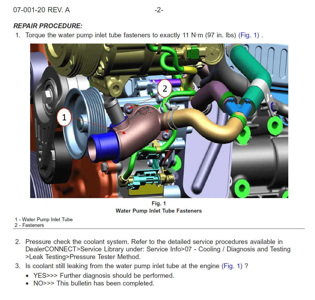

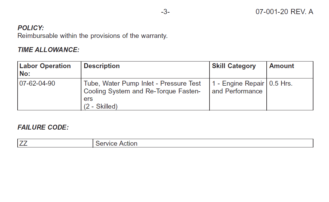

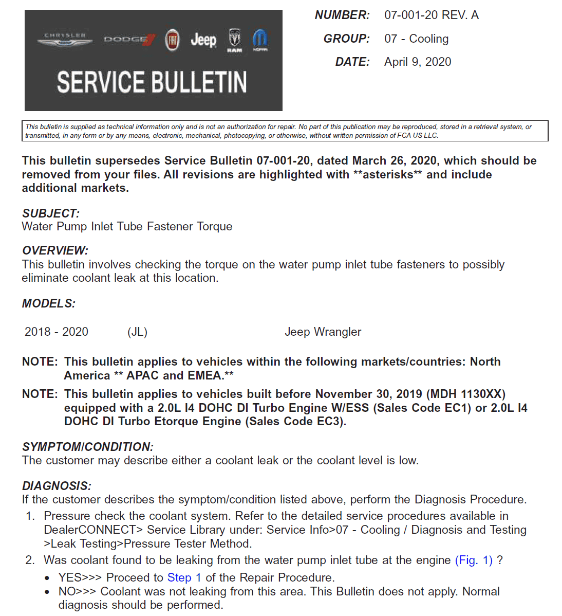

Here's the TSB for the exact issue, my jeep had the same thing, dumped all the coolant, probably ran it with out coolant for 15 miles before I noticed the temp gauge was holding at 235 and not dropping. Didn't loose the motor or pop a head gasket, happened at 10,000km/7000miles, I'm at 18,000km now, no issues yet, I don't trust it as I know those cylinder walls had nothing to cool them, time will tell.
Jeep Wrangler JL 2.0L suddenly overheated 1664937068397
Jeep Wrangler JL 2.0L suddenly overheated 1664937089702
Jeep Wrangler JL 2.0L suddenly overheated 1664937115862
Buster1
May 2, 2022
248
410
Ft Worth, TX
‘51 M38
Thx for posting the TSB. However it has been updated to be effective for 2.0T JLs built before March 2022. If your 2.0T JL/JLU was built before that, check those bolts!!

Repair Procedure
1. Remove one inlet tube fastener (Figure 1).
Figure 1 - Water Pump Inlet Tube Fasteners
  1. Apply Mopar 04318031AC (or equivalent) to fastener thread.
  2. Install the water pump inlet tube fastener and tighten to 11 N•m (97 in. Ibs).
  3. Remove the other water pump inlet tube fastener.
  4. Apply Mopar 04318031AC (or equivalent) to fastener thread.
  5. Install the water pump inlet tube fastener and tighten to 11 N•m (97 in. Ibs).
  6. Wait 10 minutes after last fastener is installed prior to pressure testing the coolant system or running the engine to allow for prescribed blue thread locking adhesive cure time.

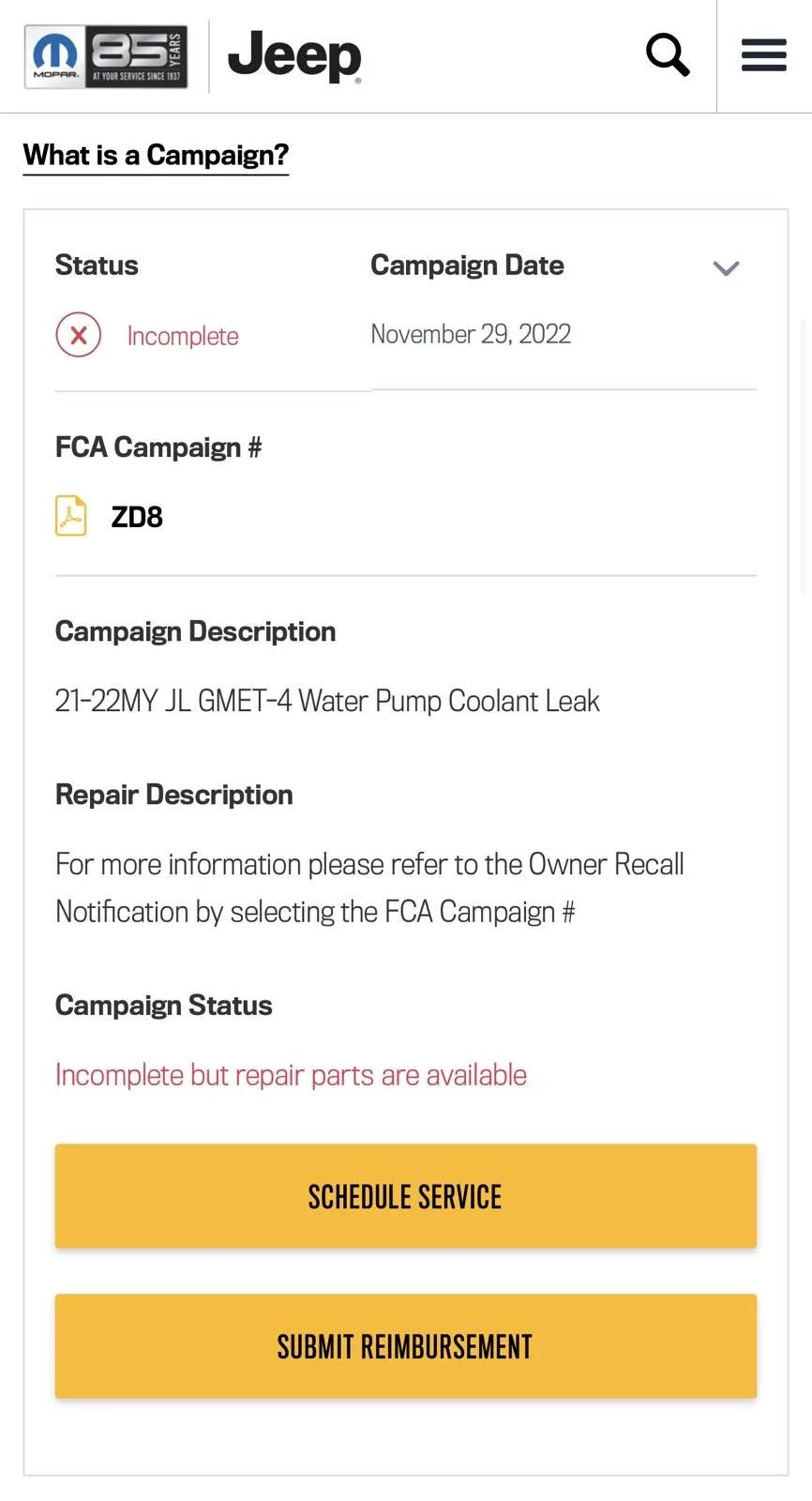

And there’s this new service campaign that I found in my owner’s site.
