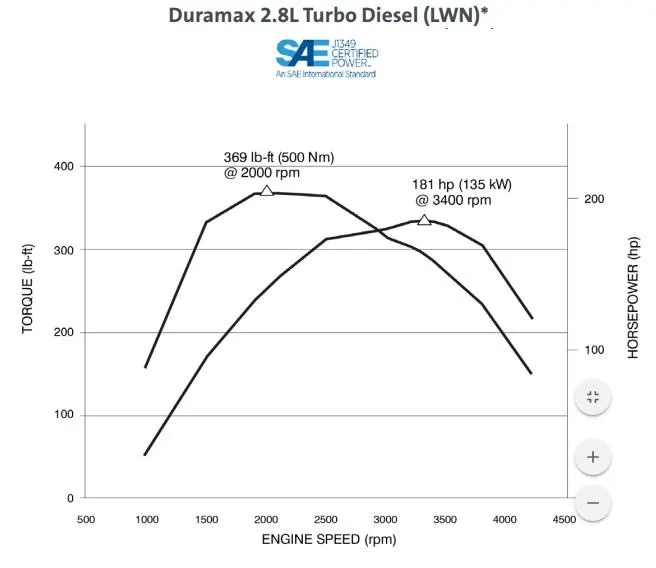

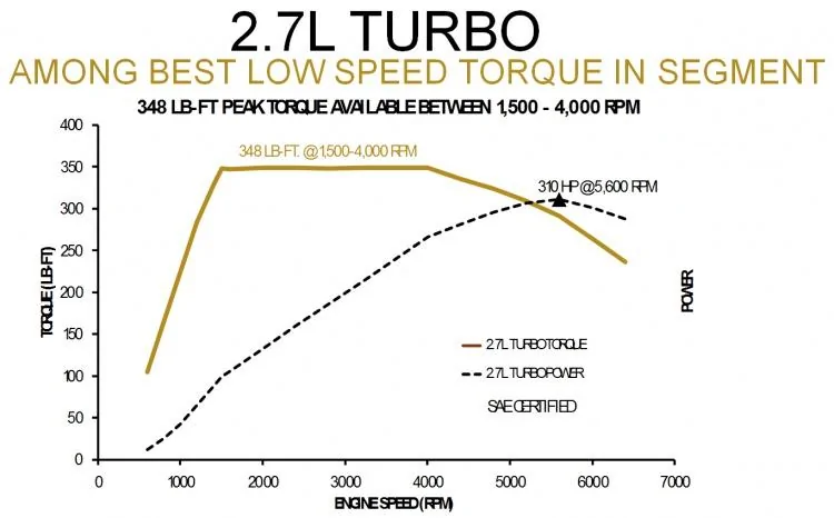

4 cylinder turbo engines have come a long way. Looking at other brands that are being offered small boosted engines with great towing capacities eg. ford EcoBoost. That new Ford Ranger coming out has a rating of 7500 lb towing capacity with a 2.3 liter turbo. Looking at Chevrolet products the 2.8 duramax torque curve compared to their new offering of a 2.7 4 cylinder turbo in the Silverado. Certainly to look at for the next few years. Small displacement turbos mimicking small diesel capabilities.
