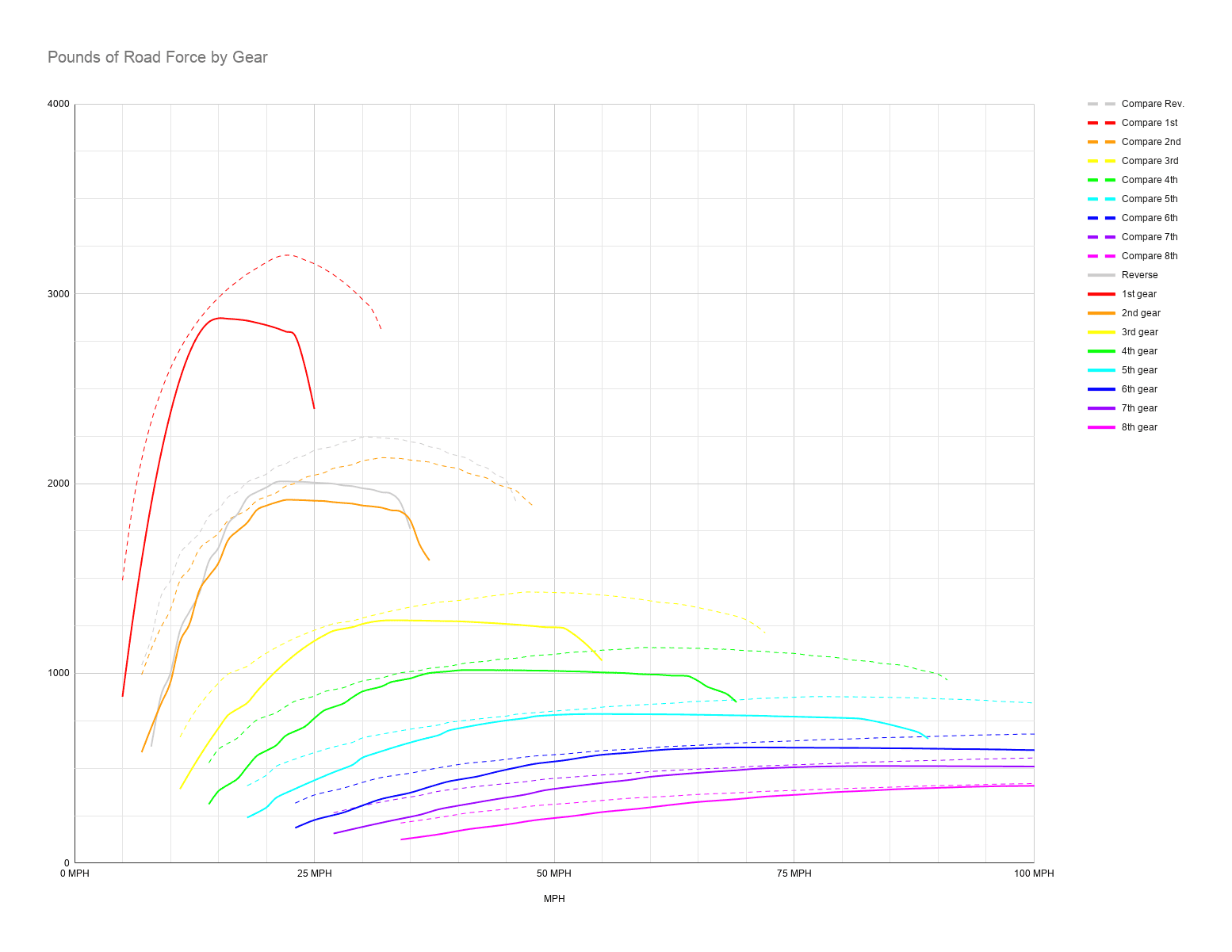

Actual meaningful data to show the difference that torque multiplication makes. People will still argue and someone will still insist that the old I6 was better than both engines. Thanks though. Interesting to see the real world difference graphed out.Here's a graph I made of the road force at the tires. While the 2.0 has more torque, the 3.6's higher redline delays the upshift to a higher speed. I suspect that this is why the 0-60 times are not much different. It's also important to note that at 75 mph in 8th gear the 2.0 has about 21% more road force (3.6 = 382 pounds, 2.0 = 462 pounds). To me this indicates that the 2.0 could handle larger tires easier than the 3.6.
Solid = 2.0 Rubicon
Dashed = 3.6 Rubicon

Agreed. I hope BSG tuning becomes possible someday.Actual meaningful data to show the difference that torque multiplication makes. People will still argue and someone will still insist that the old I6 was better than both engines. Thanks though. Interesting to see the real world difference graphed out.

I wanted to see how the 4.0 compared to the 3.6 also, but with the current Rubicon gearing & tire (as if they built a 4.0 Rubicon today). I noticed the torque curve looks strangely similar to the 2.0
Solid = 4.0 HO with 8-speed auto, Rubicon gearing/tire
Dashed = 3.6 Rubicon Auto

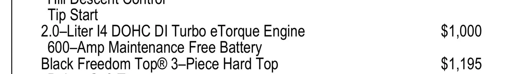

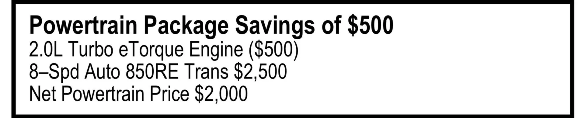

I assume that sticker is from a Sahara. No etorque on sport or Rubicon for 2020. Just regular turbo only which means $1500 more than a manual v6 and fca just bumped the auto trans price to 2750 for the v6 on sport/rubicon.The “build” pricing is not accurate for engines. Look at window stickers through the inventory (or in person at a dealership). The 2.0 adds additional cost. The 3.6 doesn’t.
From 2019 window sticker:
From 2020 window sticker:

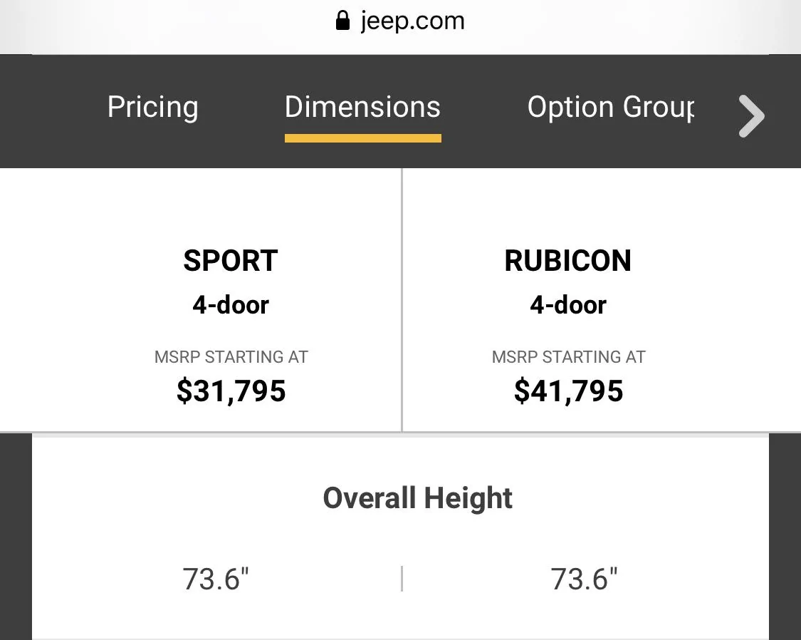

As far as engine weights go, manufacture’s websites are notorious for not annotating spec differences between sub models. Example, if you compare overall heights among models, the Sport is the same height as a Rubicon. We all know that isn’t the case. From Jeep’s compare vehicles page:
