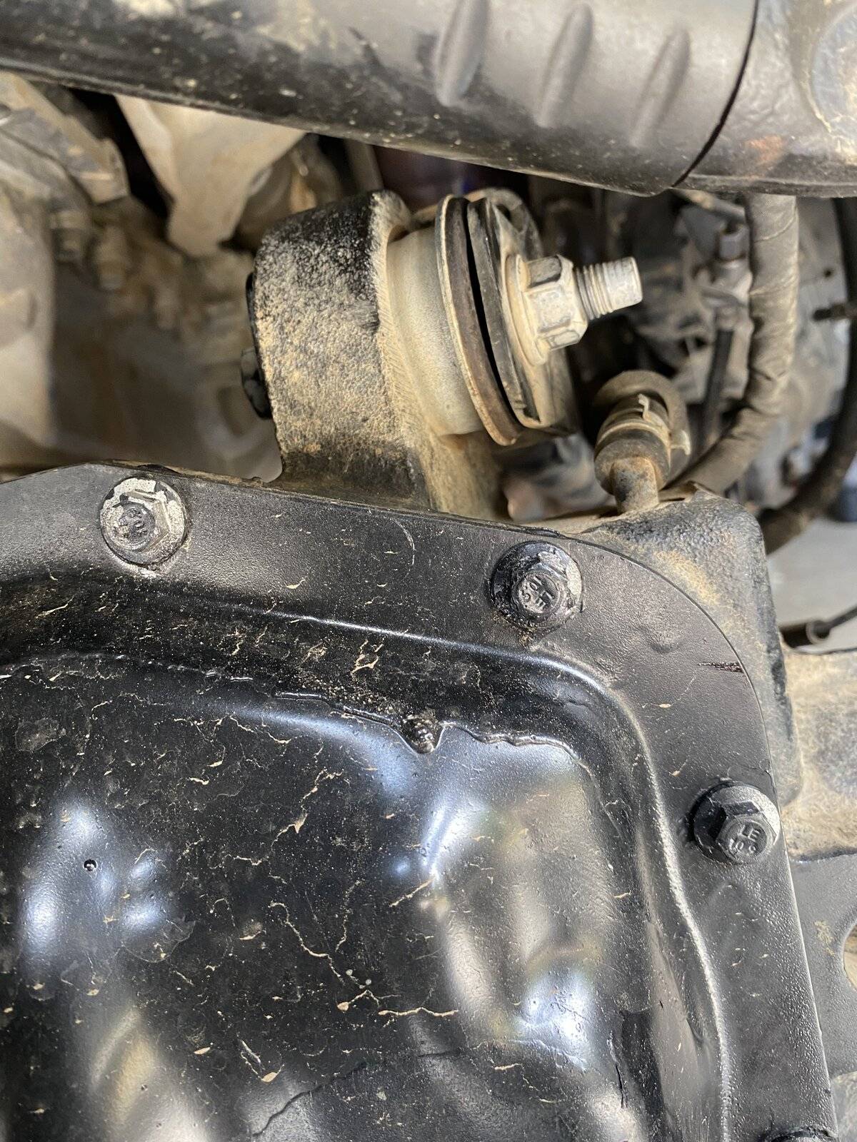

Shop was wrong. I’m at 6 degrees with a dial, but formal alignment is tomorrow. Torquing lower ball joints seemed to help, but I can feel it try to wobble. I loosened and retorqued my trackbar today. I remember frame side was super loose from the factory. I was also changing my oil and found this.
Jeep Wrangler JL 1st, 2nd, 3rd, and 4th death wobble 34FC8146-497E-433B-85CD-3257ED761F1F
I find it looks alarming, but short of bending the ends of the upper control arm inward I don’t see a way to tighten it. This is a factory arm. Is this an issue? Should there be washers/spacers?
Edit, it’s normal.Link
That's the way it's supposed to look. You mentioned a lift recently. Don't know what kind you have, but make sure axles are centered. Also make sure they equal distance on both sides. I can assure you that 9/16" made a huge difference on how mine drove. No death wobble, but definitely drove weird.
