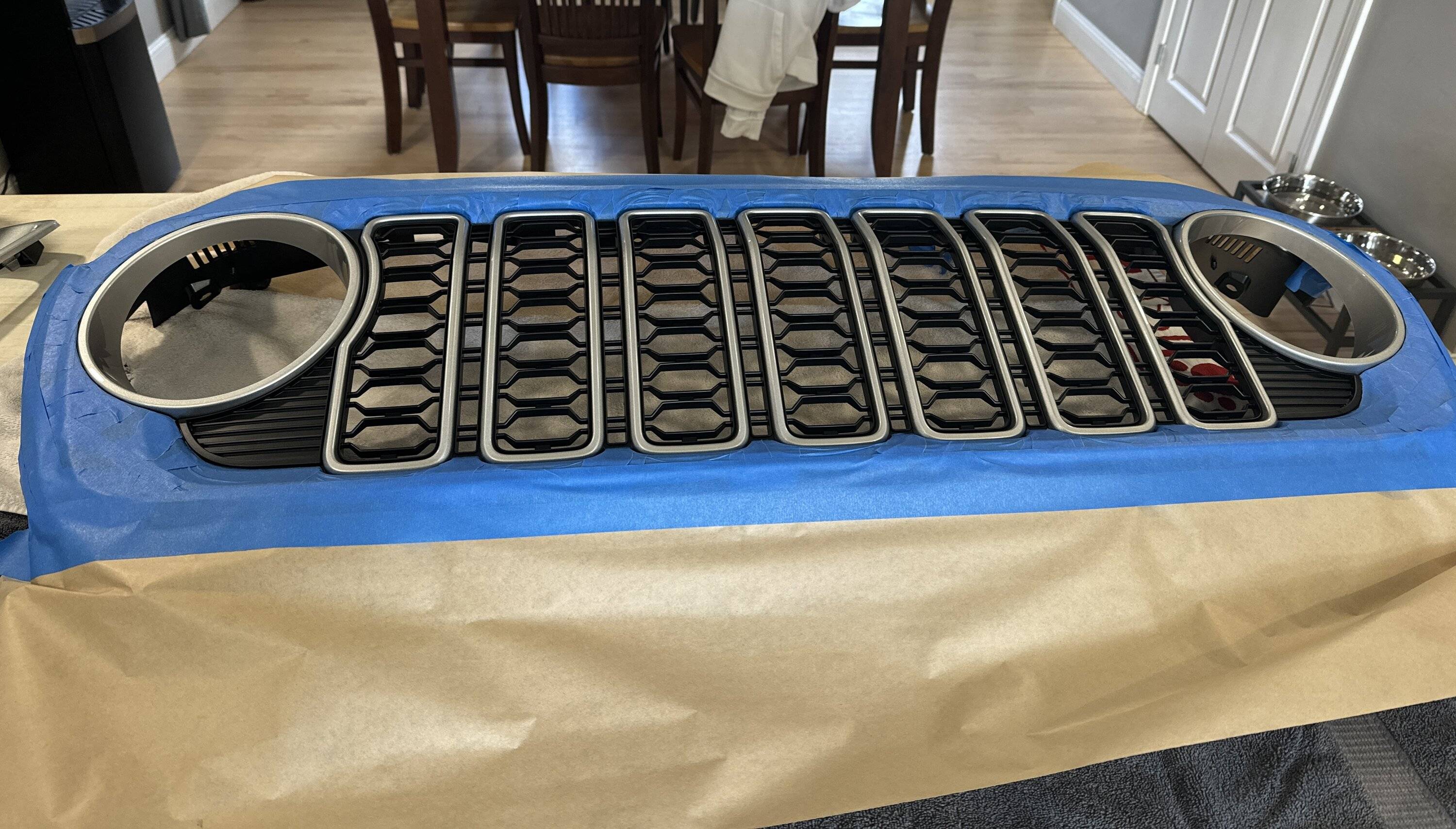

Making me real happy I just taped mine off haha! I debated for a minute but was like nahhh I can tape pretty quick. Let me say...that also wasn't a fast process but I'm sure was less stressful.

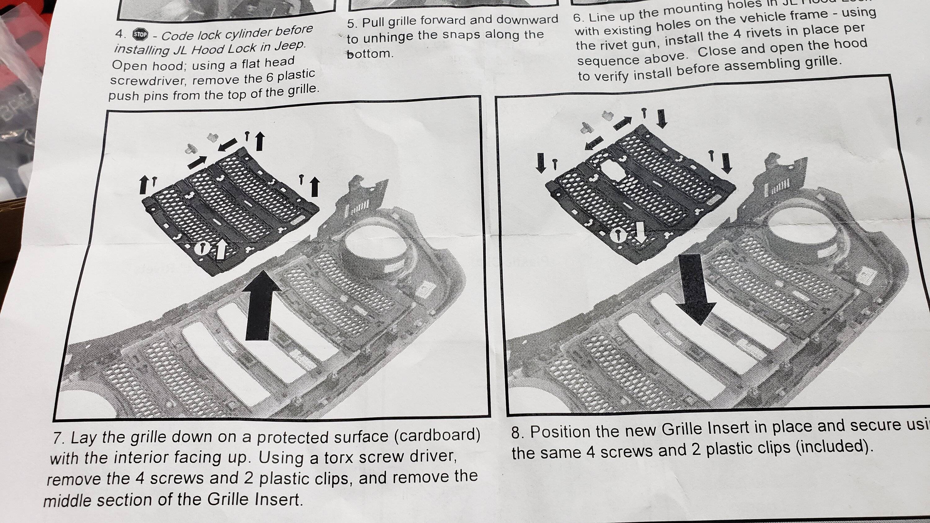

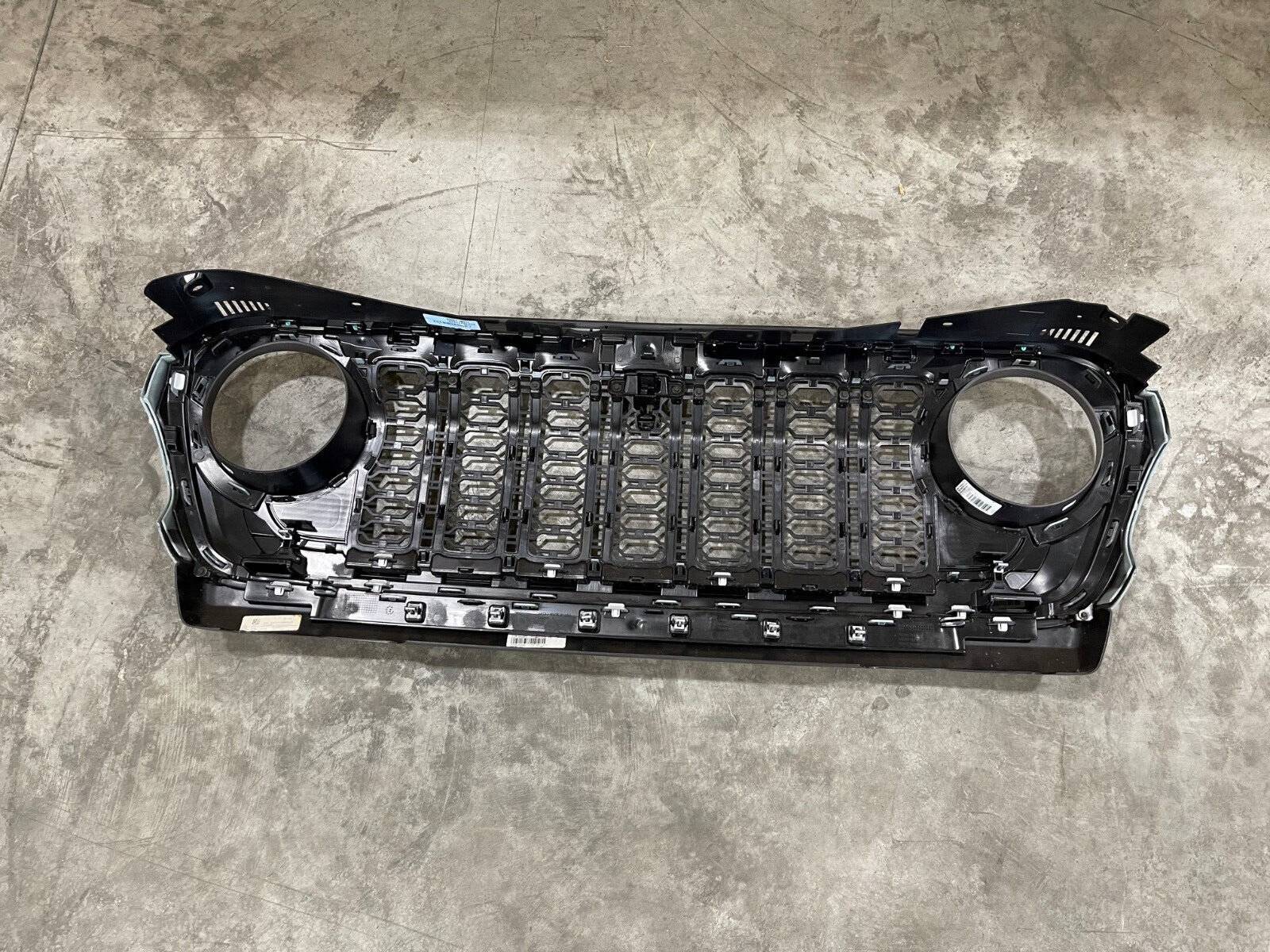

Just went thru this to swap out the plain mesh for the one with the block out for the BOLT hood lock on my '22 JLUS with '24 grille.
If I ever meet them, I think I'll strangle the committee who decided it was a good idea to use every fastener known to man (over 50 of them!) to assemble the '24 grille. Installing the BOLT grille mesh on the wife's '19 JLUS only took about 30 minutes. It took me over 3 hours to figure out how to disassemble the '24 grille without breaking anything. Another 30 minutes to reassemble it after I knew how to put it back together.
The diagram/instructions below show how easy it was to do the '19.
I've also added a pic of the back of the '24 grille showing all the fasteners.
The last pic is of the final result.
Also added a little Easter Egg of my own on the lock cover.

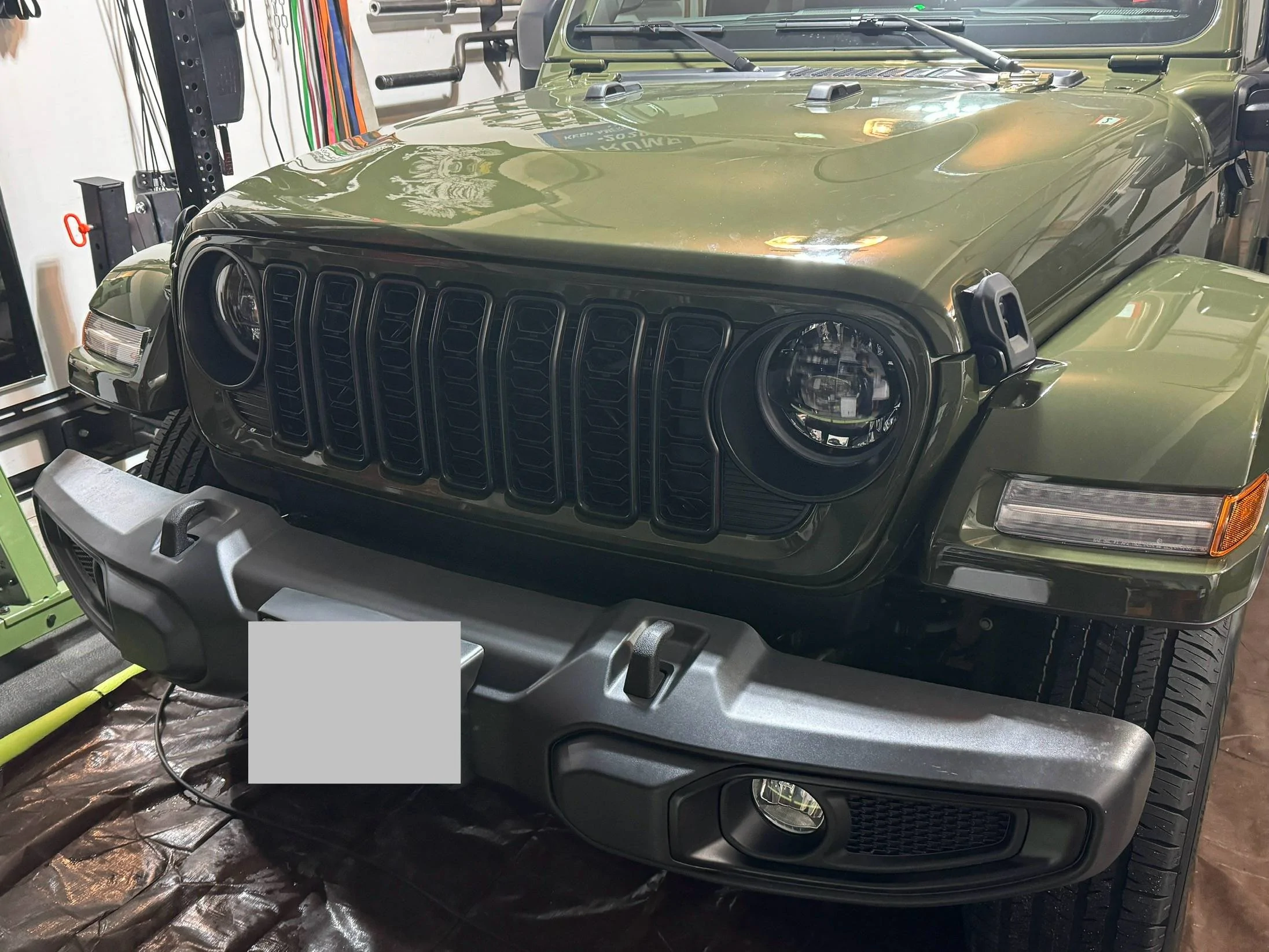

Those rivets made me go ahead with HyperDip. Took some works but worth the effort. Took the fog light trim off too without removing the bumper.
Hey there,
Looks like the trim and mesh (inside portion) are both in the same flat black or satin black/ one color (not like the black and dark grey combo that comes on the Rubi)?
Looks sharp and hence I am considering the same for my JLU
If you can share more info on the color code/ link to the product, that would be great!

Hey there,
I did spray all of it to match. First thought was just the silver trim but the taping was too much. Glad I did.
