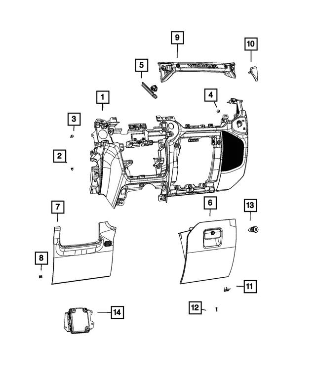

Does anyone know of the physical location of the inverter?
bump...
I found a few illustrations of MOPAR parts numbers
Voltage Converter Module - Mopar (68349348AA)
Voltage Converter Module - Mopar (68349353AA)
shown as part 14 in this image, but it does not elaborate on the location

I'd guess the module is located directly behind the plug in the console. Seems unlikely that they'd run 110V wiring any distance in the vehicle for safety reasons.

The 150 watts of 110vAC that comes out of the inverter does not seem any less safe than the 30 amps of 12vDC that can go in to it.
